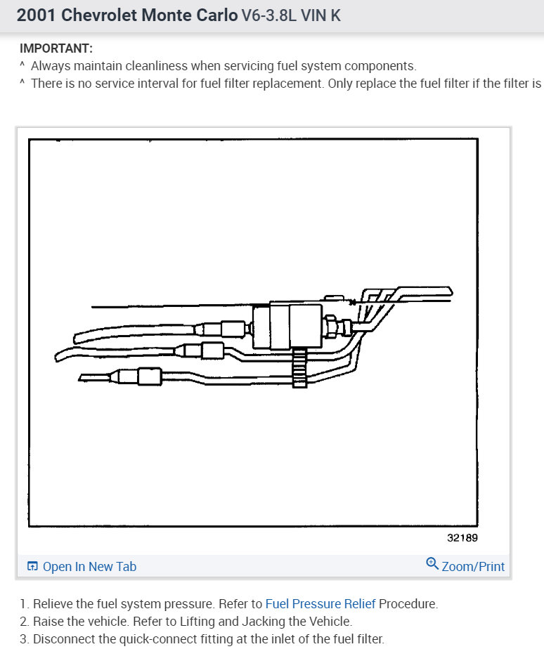

where will i find the fuel filter?
Apr 18, 2009 at 8:23 AM
JDL
  • 16,098 POSTS

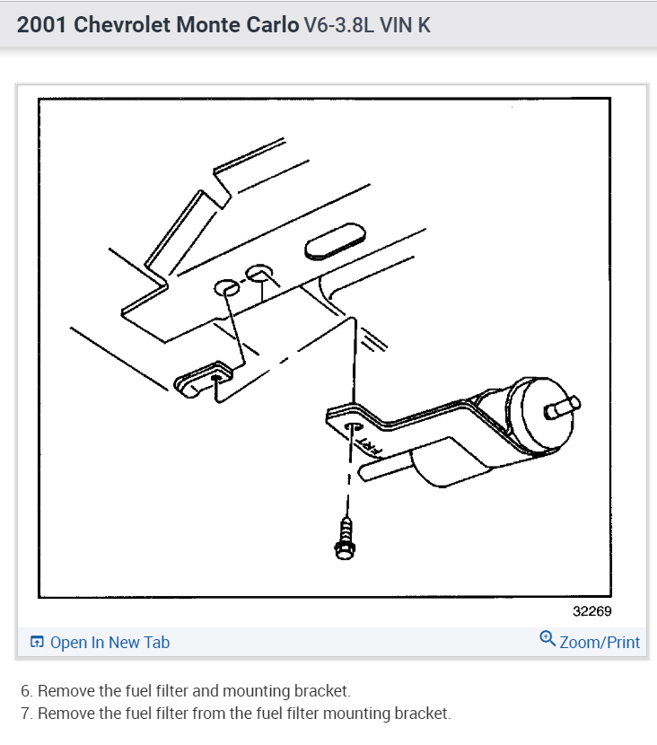

Hello, my info shows, it is located by the gas tank, you may have to get under the vehicle. Here is a guide to help you walk you through the steps and diagrams below to show you on your car.
