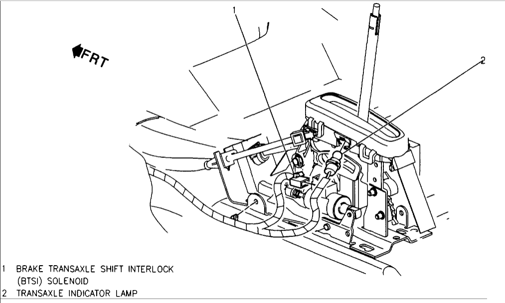

That would be called the shift interlock feature. It operates on the same circuit as the brake lights so the first thing you want to do is to make sure the brake lights are working when this problem is present. If the brake lights are working, that proves the circuit is good up to that point, then you'll have to get to the solenoid in the console. Disassemble as much as you have to to access the solenoid near the shifting mechanism. Us a 12v test light to test for power coming and going at the solenoid when the brake is applied. If power is arriving and switching and the solenoid is not triggering, the solenoid is bad and will have to be replaced.

It sounds like you have a interlock shift solenoid that has gone out or a fuse that is blown.
I would check the fuses first and then use a test light to see if the solenoid is getting power and if so replace the unit. Here is some guides and diagrams (below) that will help you get the problem fixed:

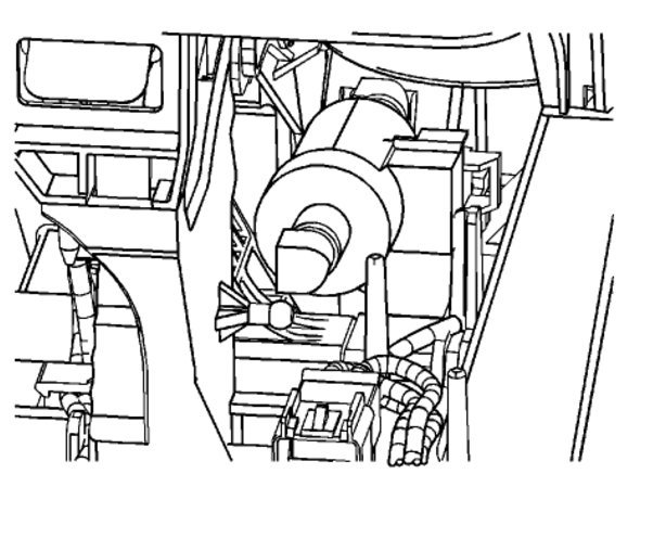

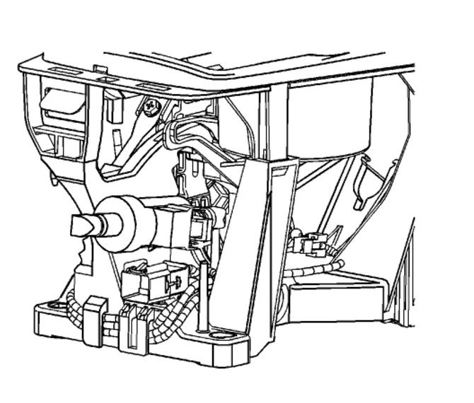

There is a shift interlock solenoid that sticks on these cars. Below is a diagrams to help you see if it is working. When you press the brake pedal down also check to see if the brake light work. You may need to replace the solenoid.
Check out the diagrams (below). Please let us know what you find.
