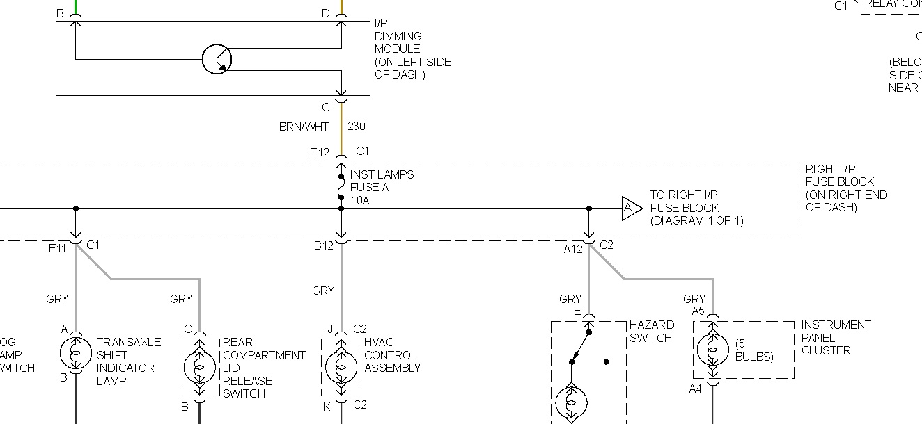

I have automatic light in my 2003 Chevy Malibu, and recently the dash board and radio lights do not come on at night. The headlights work fine. The radio works fine; just no lights. During the day the radio lights do come on, and all of the non-backlight lights (IE. Door Ajar, Check Engine, Airbag, etc...) works on the dash during both the day and night. I have checked all of the fuses, but none were burnt out and all passed on a fuse checker. Help!!
Apr 25, 2020 at 1:26 PM (Merged)
JDL
  • 16,098 POSTS
Use a voltage tester at the instrument lamp fuse, with lamps turned on. If no voltage backtrack the circuit.

On my '98, there is a one-transistor regulator mounted to a bracket above the brake pedal near the steering column. T0-3 case - 2N3055 or ECG 130 perhaps. More 2 come...

All the warning lights come on, check fuses on both sides and underhood, they all have power, tail lights work.
Replaced dimmer switch, replaced light/wiper switches
I still have no dash lights....hard to drive at night....
Do you have wire diagram?
BMRFIXIT
  • 19,053 POSTS
does the radio and clock and the other dash light if any work and dim
if so u need to replace the light bulbs in the back of the instrument panel
if not turn light on and check fuses

BMRFIXIT
  • 19,053 POSTS
turn light on and check the fuses again
check headlight switch
check wiring
radio panel lights and shifter light all come from one source
