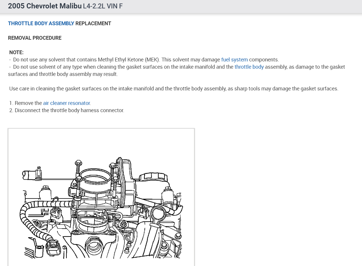

i need to replace my tps on a 2005 malibu 2.2 dont know where it is i have the new one and am unable to see where the old one is?
Jan 17, 2009 at 2:15 PM
OBXAUTOMEDIC
CERTIFIED EXPERT
3,711 POSTS
There is no IAC valve on this car idle control is done by the throttle actuator here is its location in the diagrams below. Check out the diagrams (Below). Please let us know if you need anything else to get the problem fixed.
