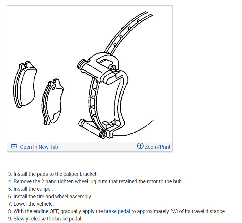

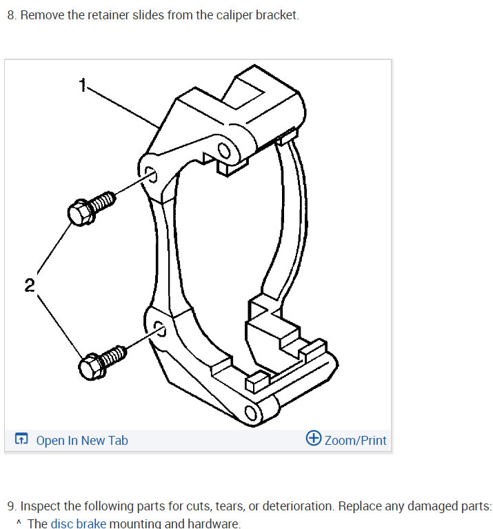

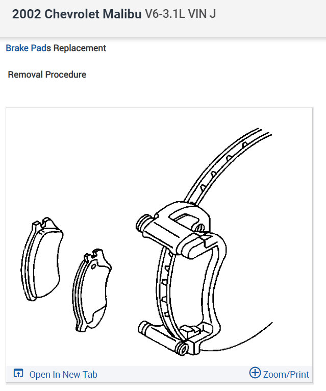

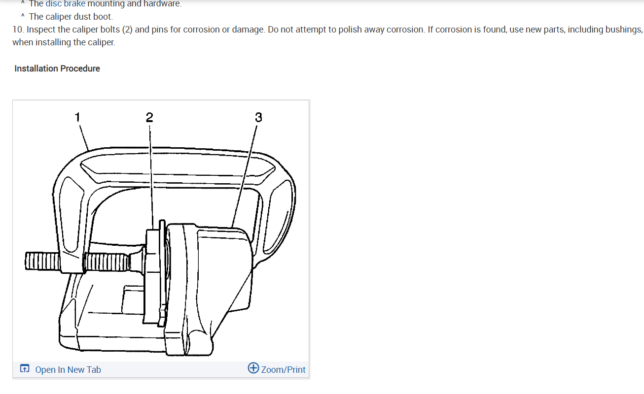

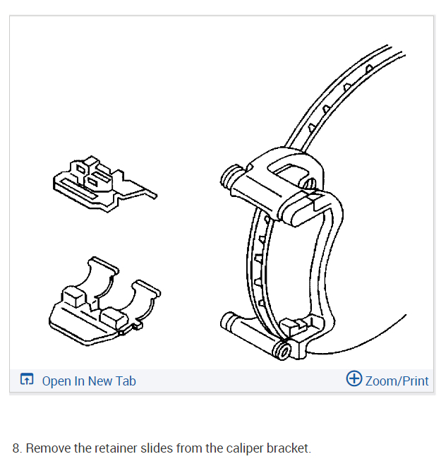

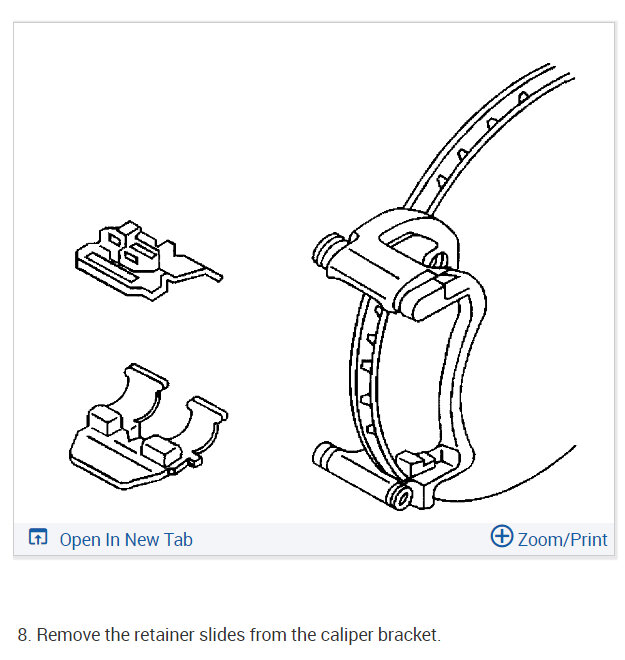

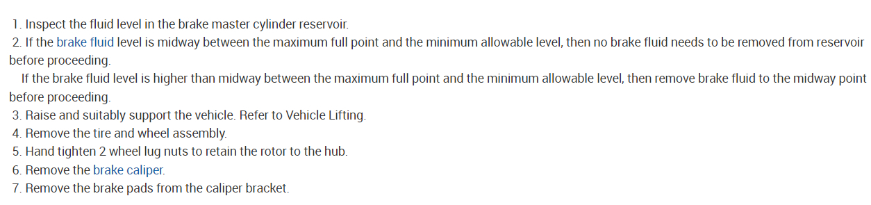

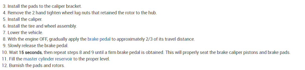

Yep, I agree with BMRFIXIT you need front brakes because the pads have a screamer on them. Here is how to change them out in the images below. Check out the images (below). Let us know how it goes.
