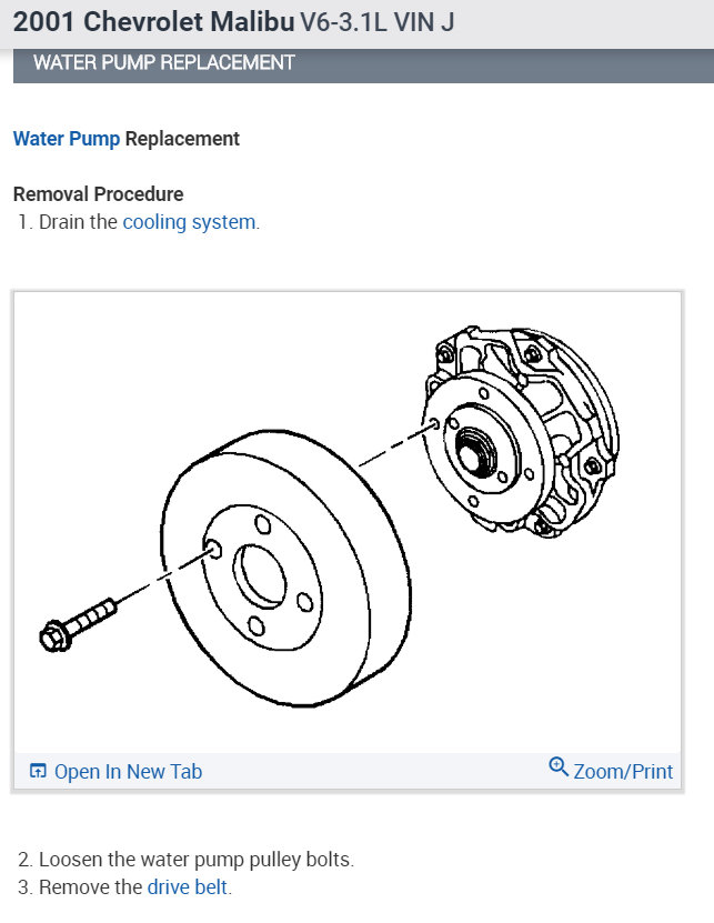

How do you install the water pump so the bolt pattern is correct.
Feb 13, 2010 at 7:25 PM
BLUELIGHTNIN6
CERTIFIED EXPERT
16,542 POSTS

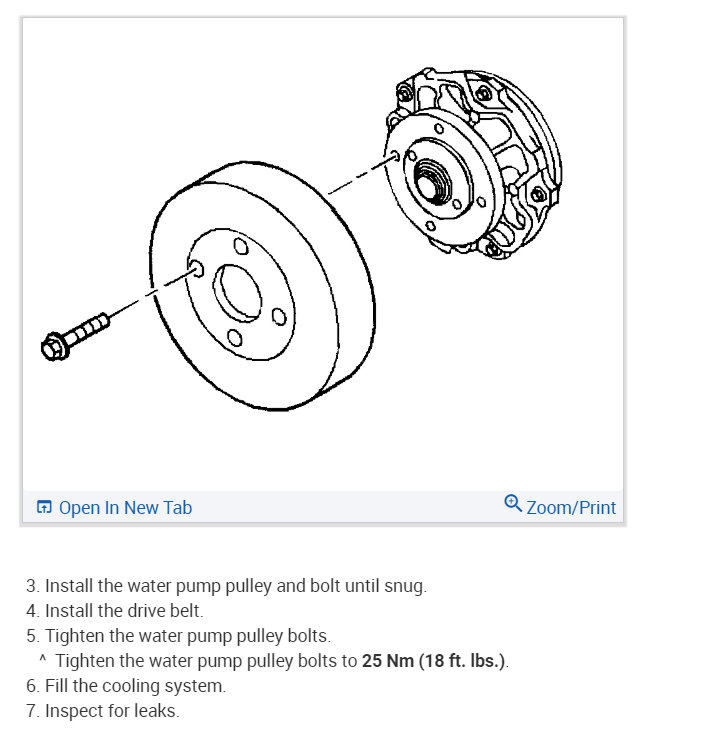

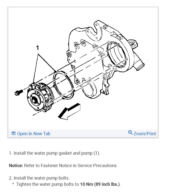

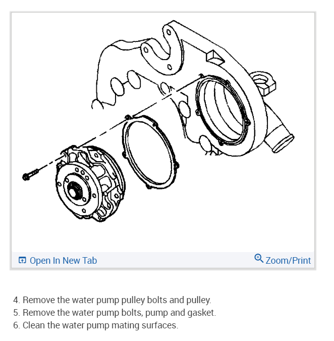

This guide will help walk you through the steps and I have included the instructions to replace the water pump in the diagrams below
https://www.2carpros.com/articles/water-pump-replacement
