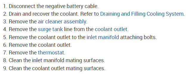

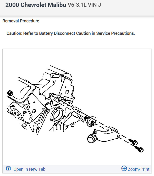

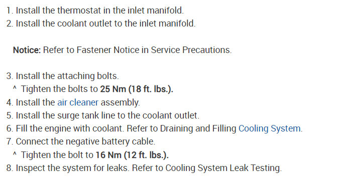

How difficult is it to replace the thermostat in this vehicle?
2000 CHEVROLET MALIBU
81,000 MILES • 6 CYL • 2WD • AUTOMATIC
LUTHERGOODEN
Dec 13, 2007 at 7:21 PM
BMRFIXIT
  • 19,053 POSTS
[quote:80a36fb057="luthergooden"]Heater problem
2000 Chevy Malibu 6 cyl Two Wheel Drive Automatic 81,000 miles
How difficult is it to replace the thermostat in this vehicle.[/quote:80a36fb057]
its only two screws but I tell you it a capital B to do one of them
Dec 14, 2007 at 9:51 PM
It is not to bad, they are two 13mm bolts, here is a generic guide to help you step by step with instructions in the diagrams below to show you how on your car.
