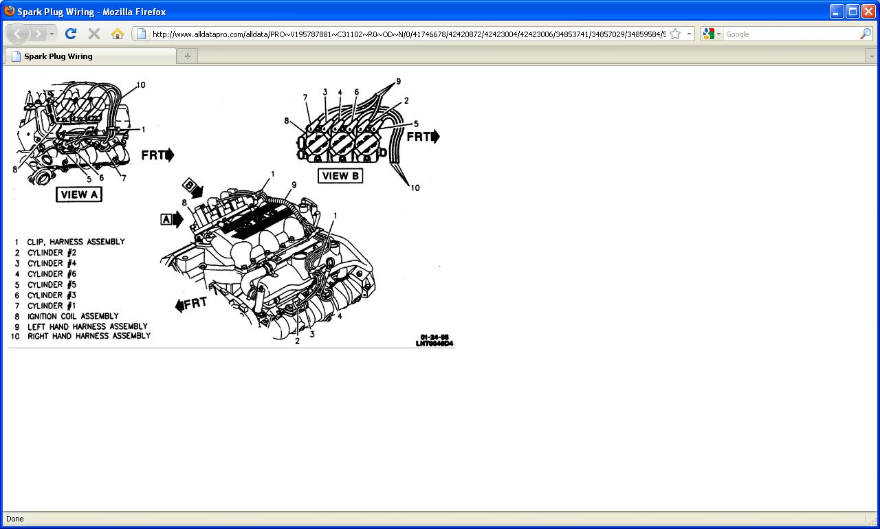

SATURNTECH9
CERTIFIED EXPERT
30,869 POSTS
There right below the valve cover's i posted a diagram follow the spark plug wire's from the coil's to the spark plug's.
Image (Click to enlarge)

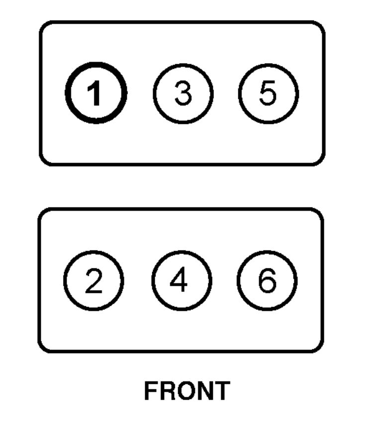

BLUELIGHTNIN6
CERTIFIED EXPERT
16,542 POSTS
Firing Order .................... 1-2-3-4-5-6
Here is the cylinder numbers for the 3.1L
See attachment below
