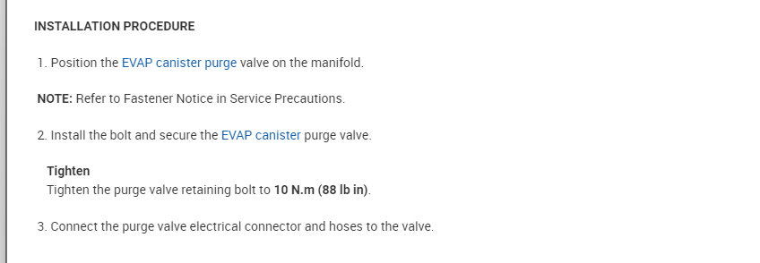

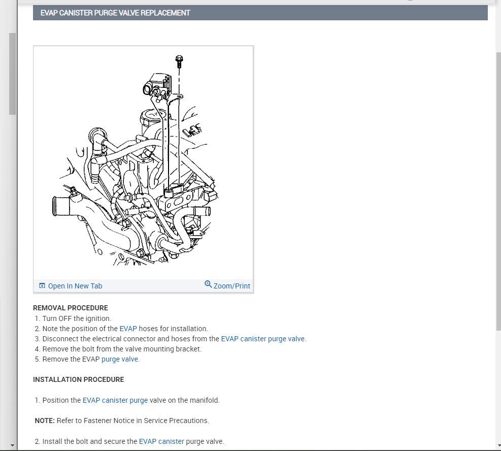

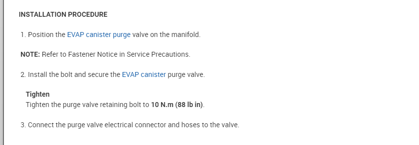

I don't think this is an injector issue. More than likely this is a purge valve is stuck open and it is just dumping vapor in the intake when it should not be.
Basically, this is causing the engine to run too rich, and it normally causes an issue when the throttle blades are closed because this is the time that there is the smallest amount of air coming in and if there is too much fuel from the evap emission system then it is going to cause the engine to hesitate and even stall at times.
https://www.2carpros.com/articles/engine-hesitates
I am attaching the info from the manual on replacing this which is what I would do.
Basically, when you remove it, check to see if there is any chalk looking substance inside of it. If there is then you more than likely have raw fuel in the charcoal canister which breaks the charcoal down.
Please let us know what questions you have. Thanks
