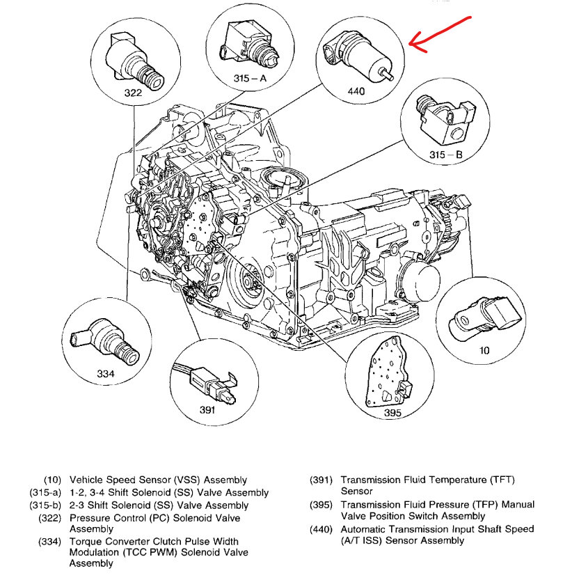

It is possible that the input shaft speed sensor is causing this issue. Here is the location of the sensor so you can swap it out also we should run the codes to see if any are stored that can point us in the right direction.
Check out the images (below). Let us know how it goes
