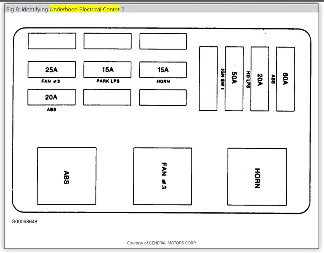

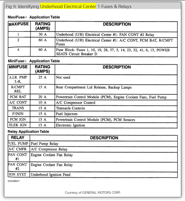

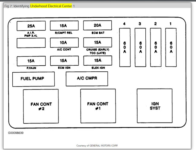

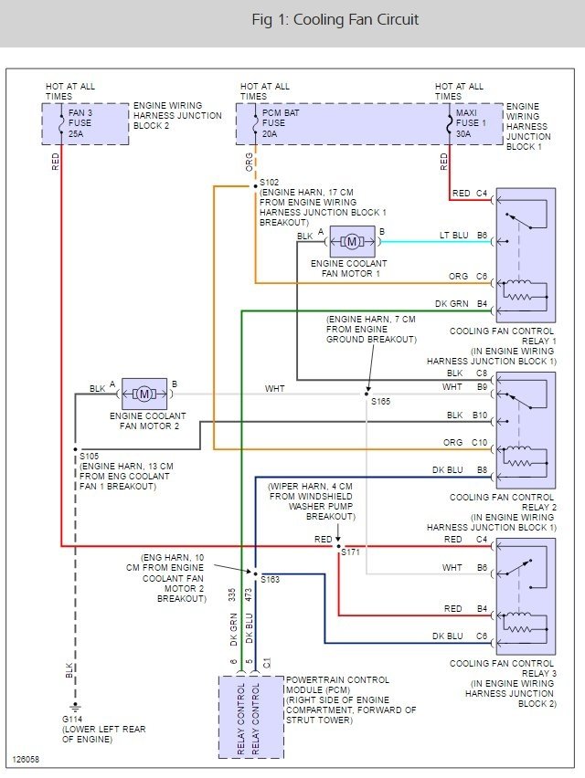

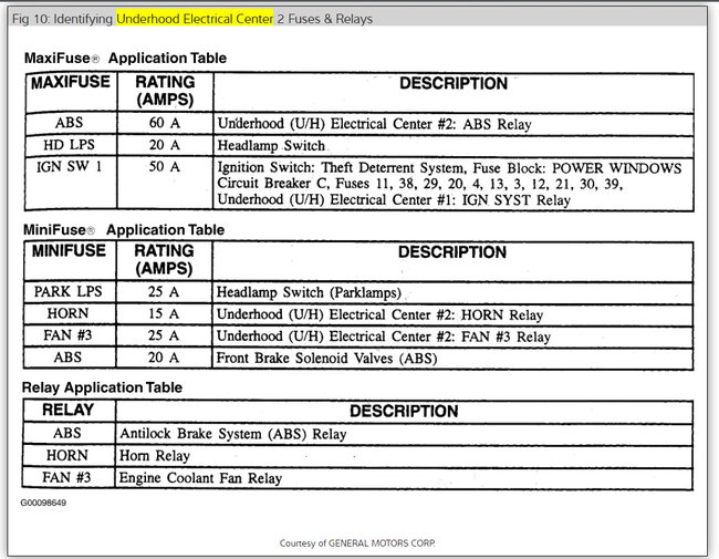

This sounds like you have a fuse out #3 fan fuse 25 amp but to be sure here is a guide to help you check the fuse with the location in the diagrams below I also included the cooling fan wiring diagrams so you can see how the system works.
Check out the diagrams (Below). Please let us know what you find. We are interested to see what it is.

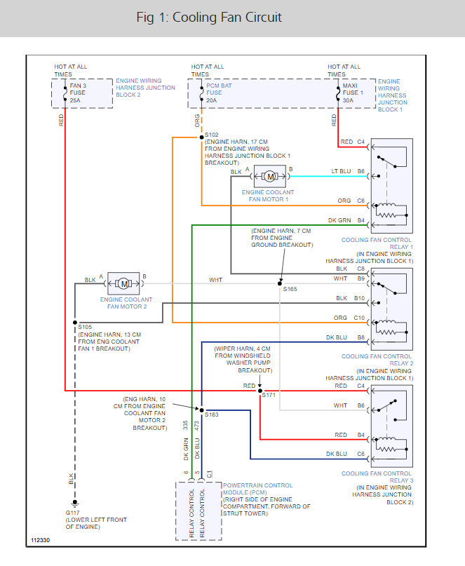

You must have a wire that is not getting a good connection or a relay is not working correctly, here is a cooling fan wiring diagram (below) you can use for testing and a guide that will show you how to get the problem fixed.
and
Please run some tests and get back to us so we can continue helping you.
