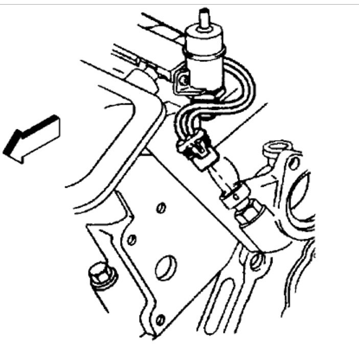

Here is a guide that will show you what you are in for when doing the job with a diagram (below) of what is like on your car.
