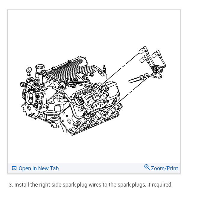

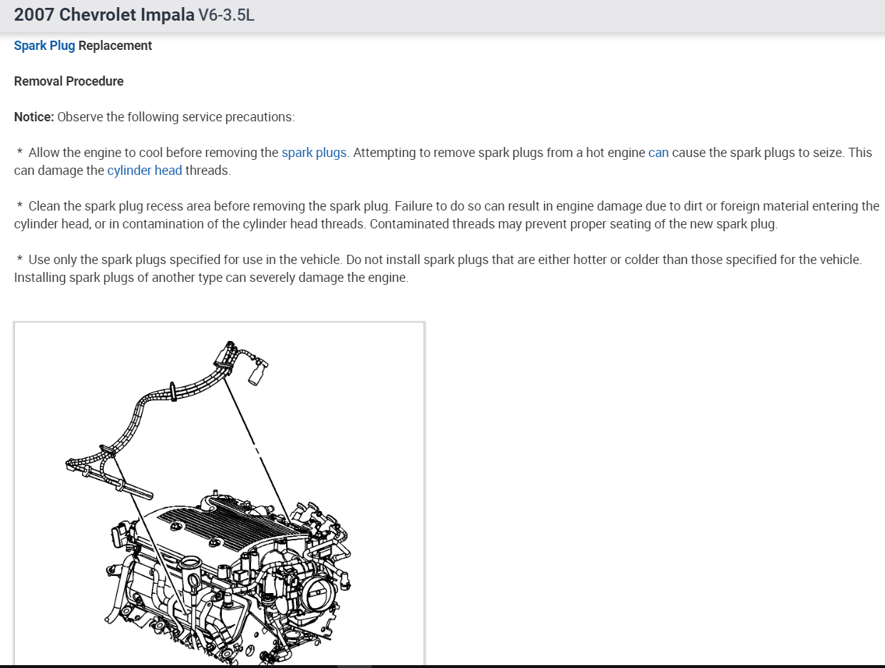

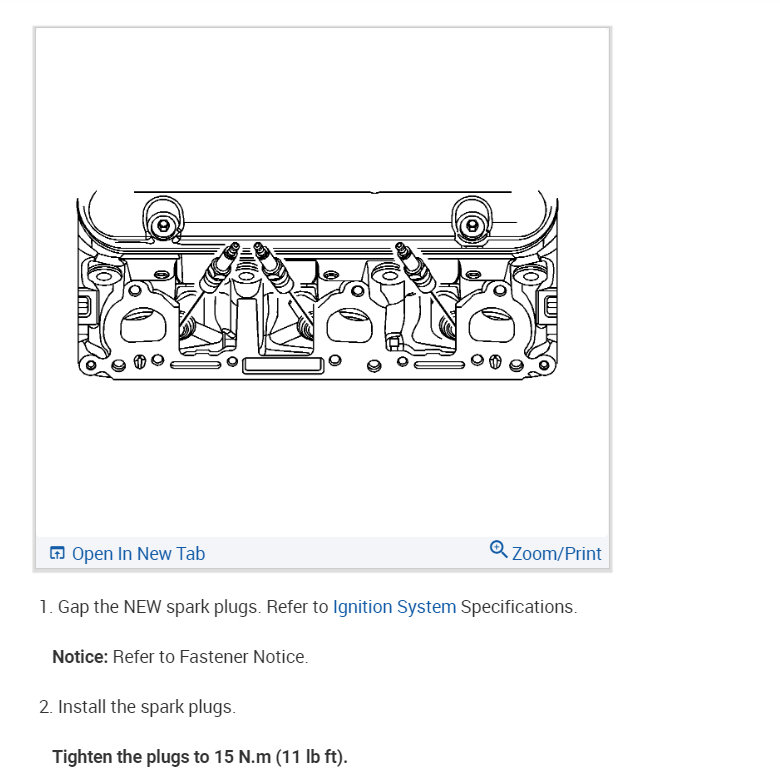

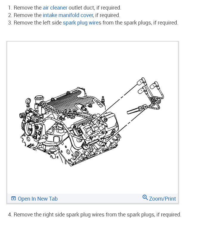

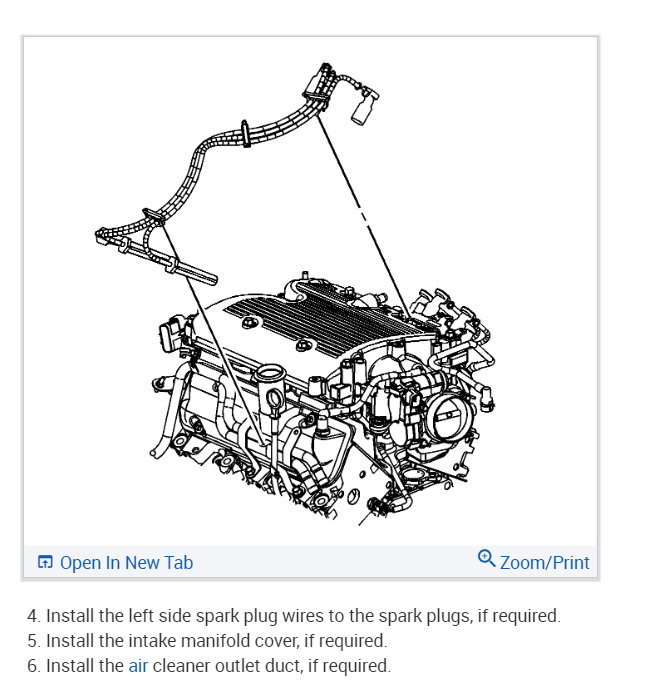

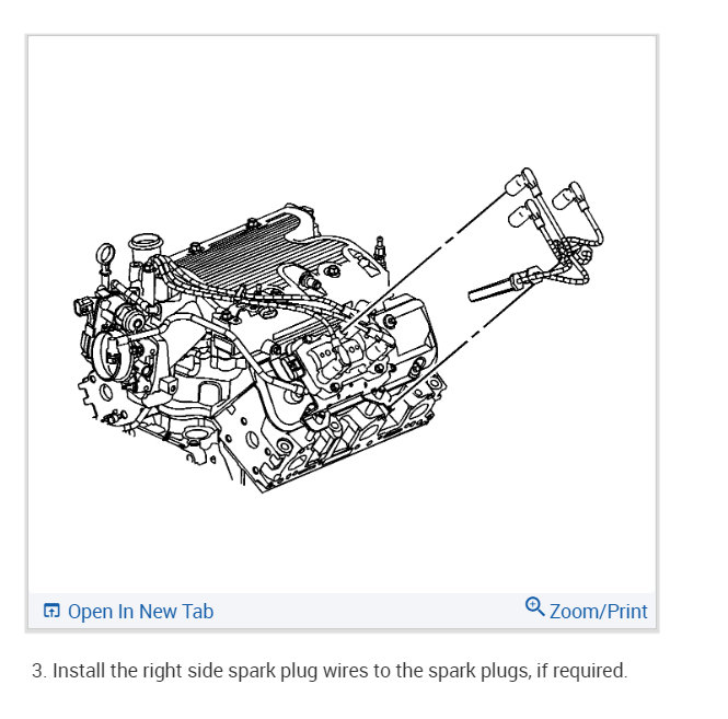

your plugs in that car should be good for 60,000 miles. as for performance plugs, i would suggest using what the factory calls for. Here is a guide to help walk you through the job with diagrams below to show you how on your car.
https://www.2carpros.com/articles/how-to-change-spark-plugs
1.02 mm (0.040 in) gap
Spark Plug Type .................... GM P/N 12591131 (AC Delco #41-100)
