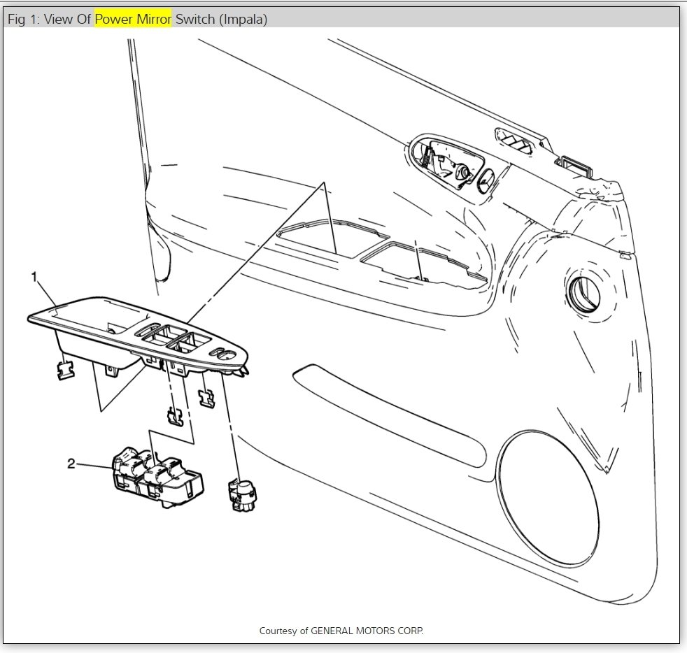

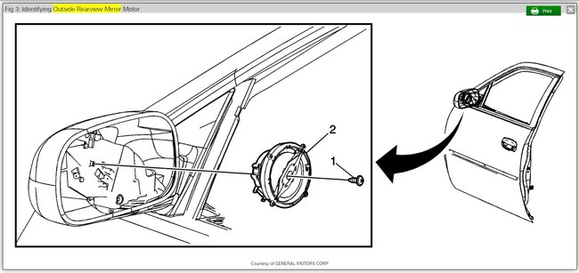

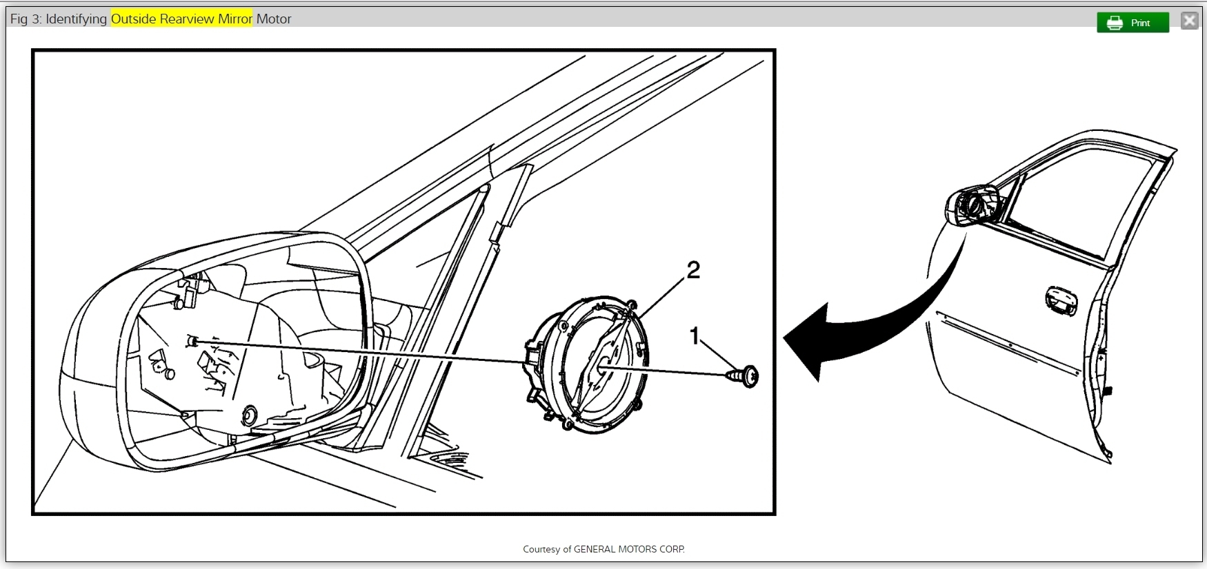

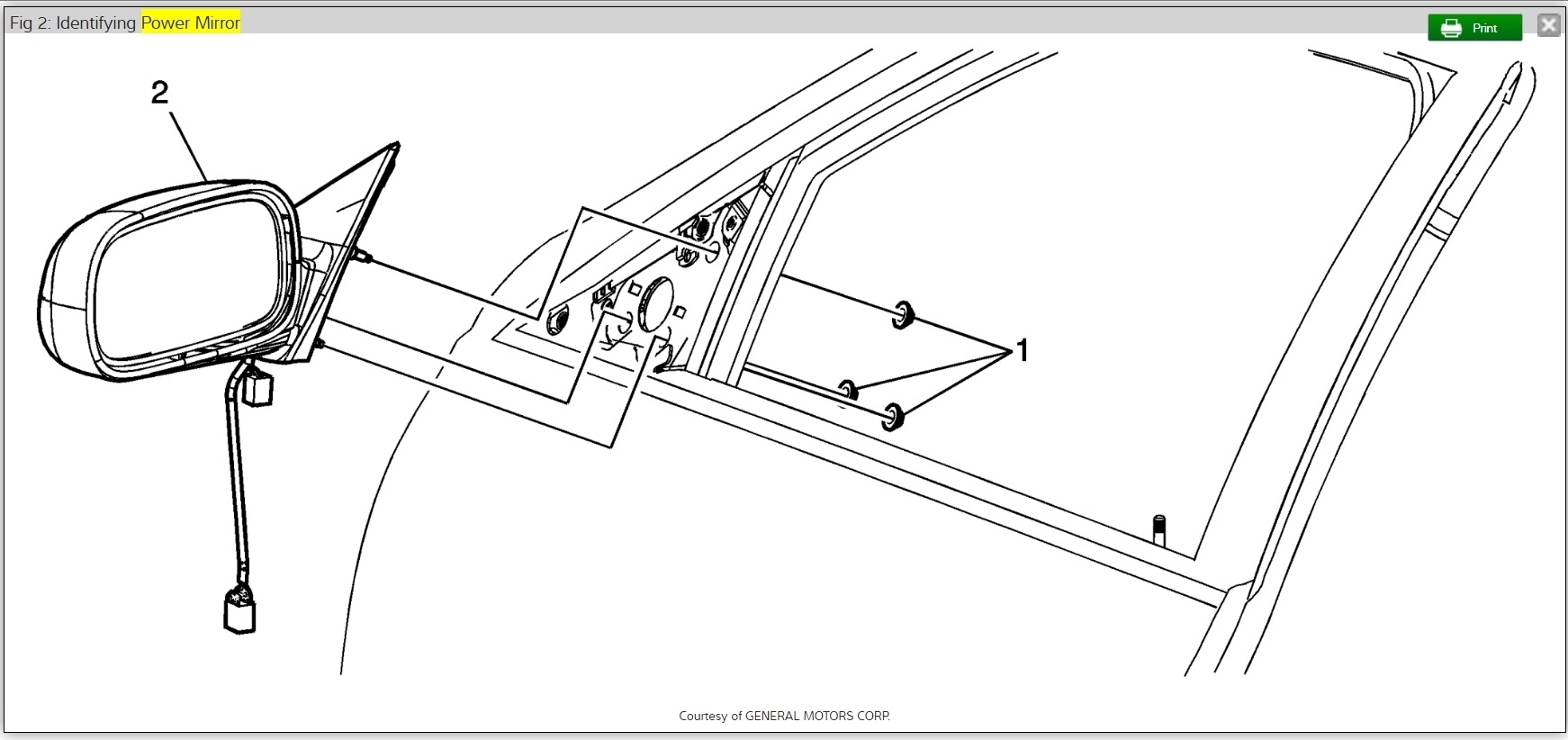

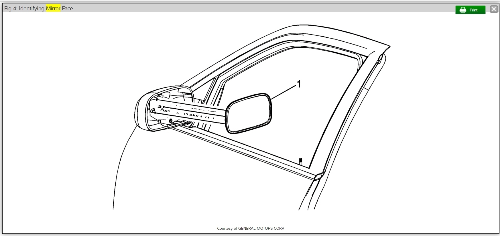

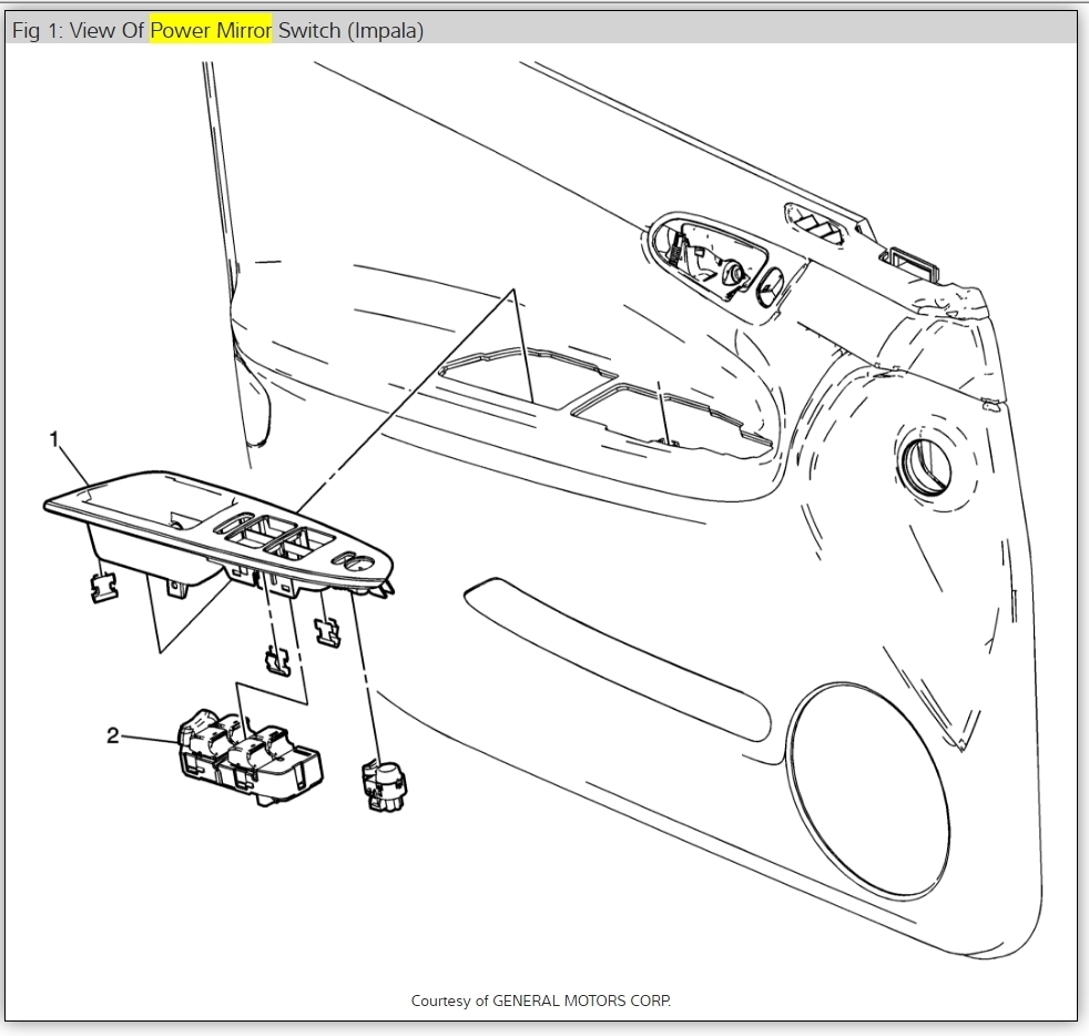

Hey JALLEN18,
Replacing the mirror is not too bad, it will take minor tools and a small standard screwdriver.
You may need to remove the door panel which we have a guide for below.
https://www.2carpros.com/articles/door-panel-removal
I have also included some diagrams below.
Please let me know if you need anything else
Best, Ken
