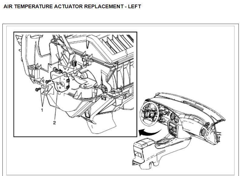

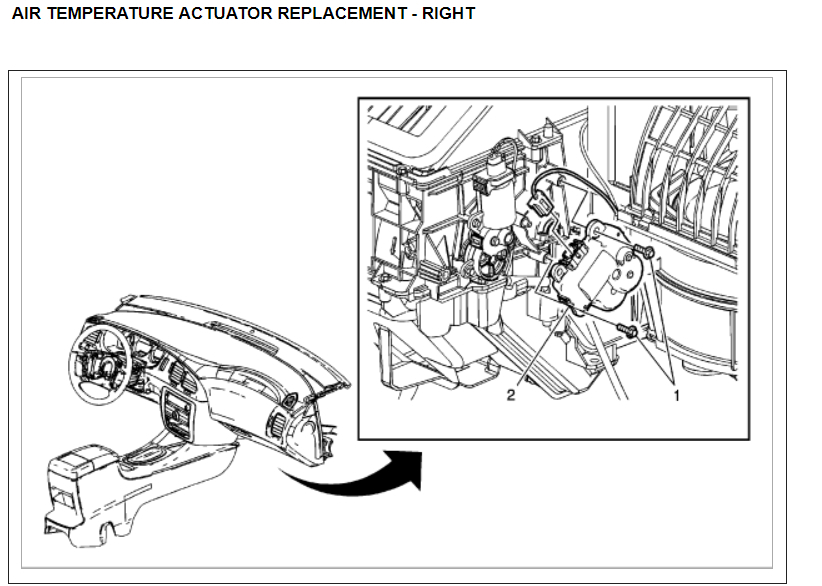

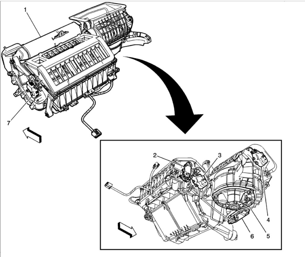

This sounds like you have a problem with the blend door actuator for the temperature. Here is a guide to help you see what I am talking about.
Here is the location for your car (below)
Feb 12, 2018 at 2:27 PM
