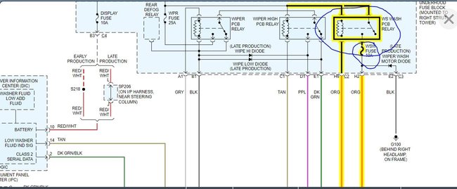

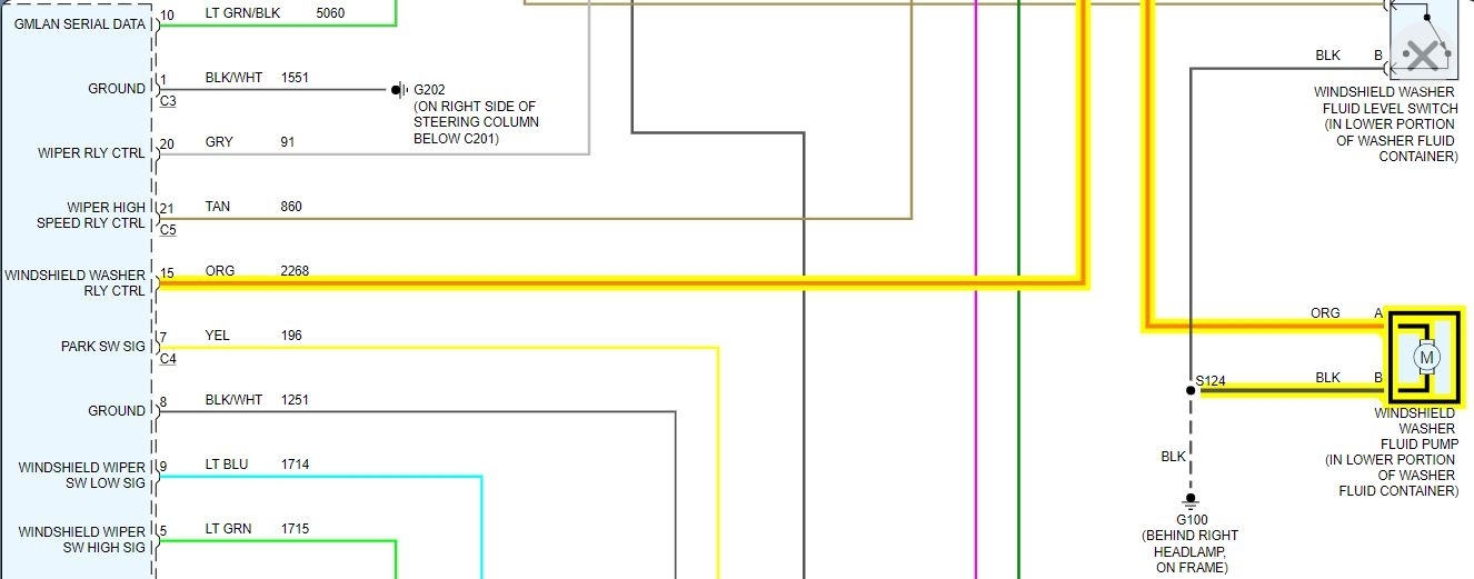

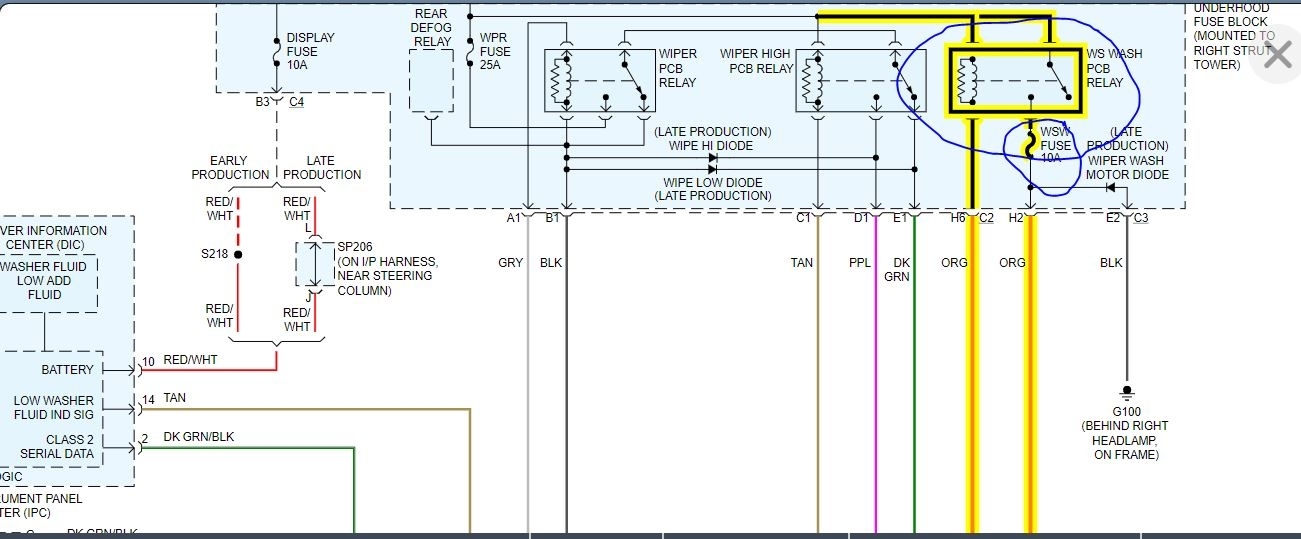

Good morning,
I attached a diagram for you to view.
The washers are controlled by a relay. The relay is operated by the body control module based on a signal from the washer switch input.
You need to test the fuse in the circuit for power on both sides while someone commands the pump to work.
