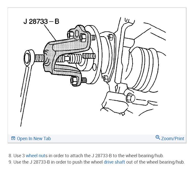

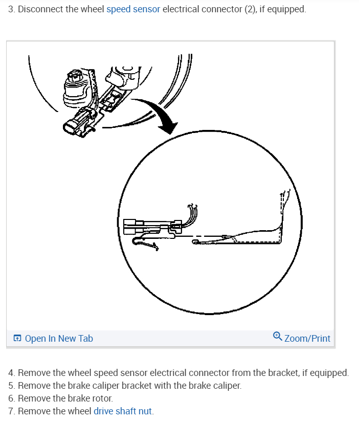

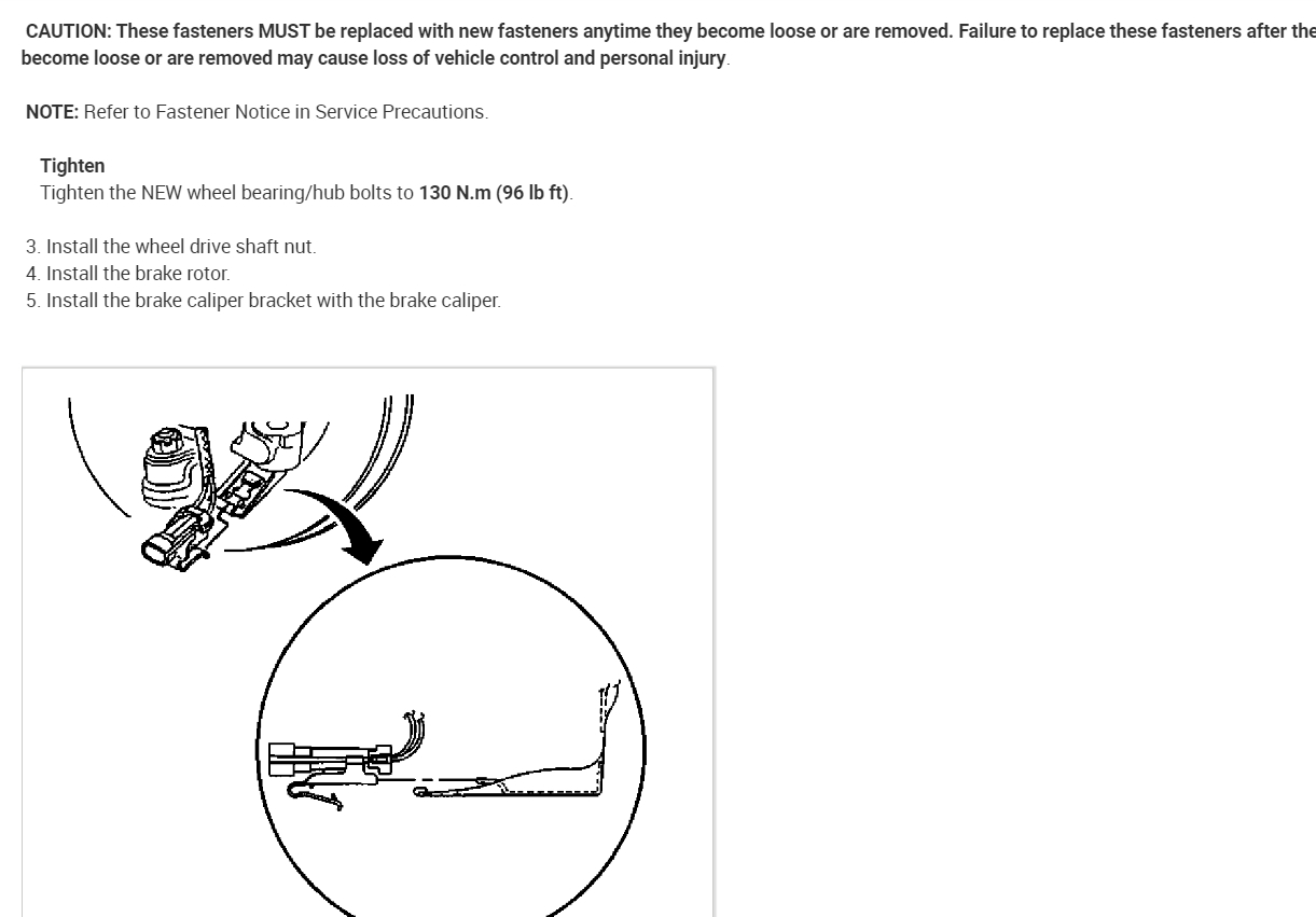

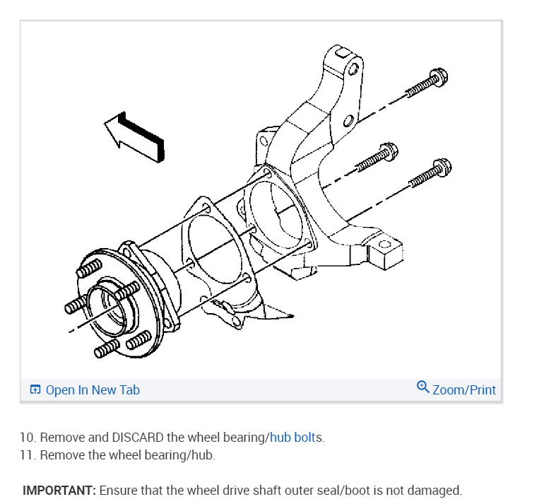

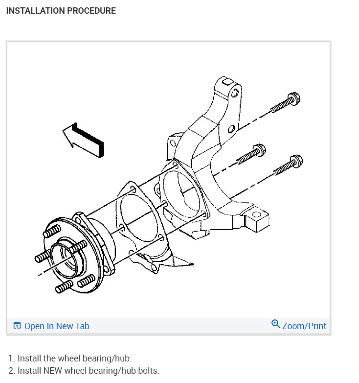

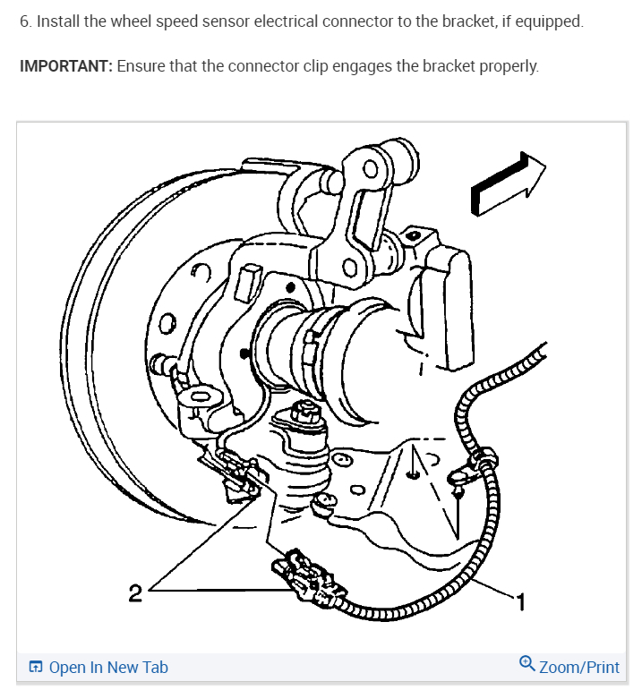

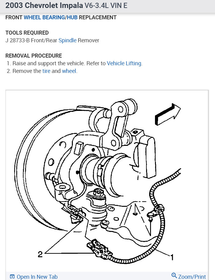

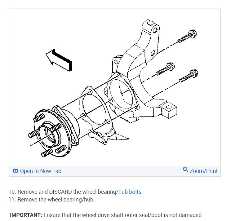

This sounds like to me the front bearing hub is going out. I would raise the front of the vehicle and see if the front wheel has play, if so, here is how to change the bearing hub out. Check out the images (below). Please let us know what happens.
Sep 15, 2023 at 11:25 AM
