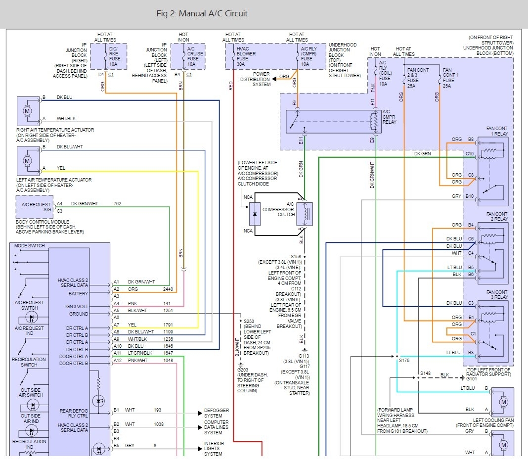

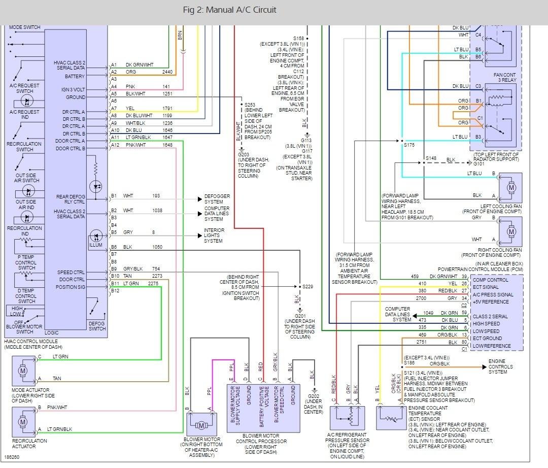

this vehicles climate control will not come on, the blower motor is not working,the a/c button doesn't light up when pressed.i found that in the fuse block on the drivers side of the dash that the blower motor fuse has no power. if i supply that fuse with power then everything works normally.all other fuses are good. my main question is,where does this fuse receive power from. thank you for your help in advance.
