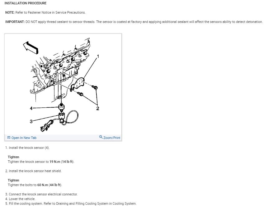

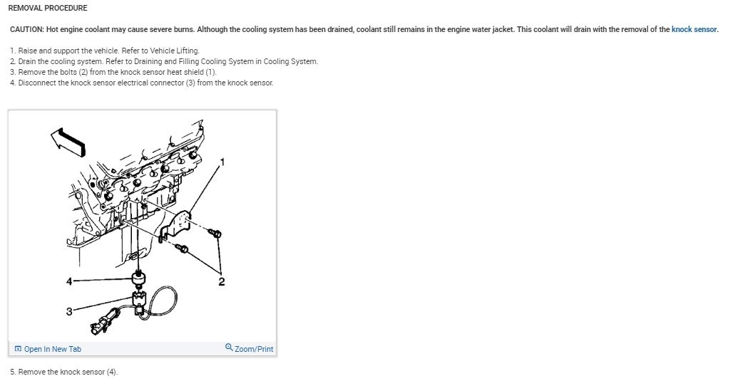

This knock sensor is very difficult to replace. It is on the back/bottom of the engine next to the trans axle.
See the diagrams below for instructions on replacing it

the transmission has to come out then drain cooling system. remove shield around it . I do not see any tips from mechanics. maybe if you got lucky and used an open end wrench from the side . Be sure not to over tighten if you do it destroys the sensor and you have to replace it again.
