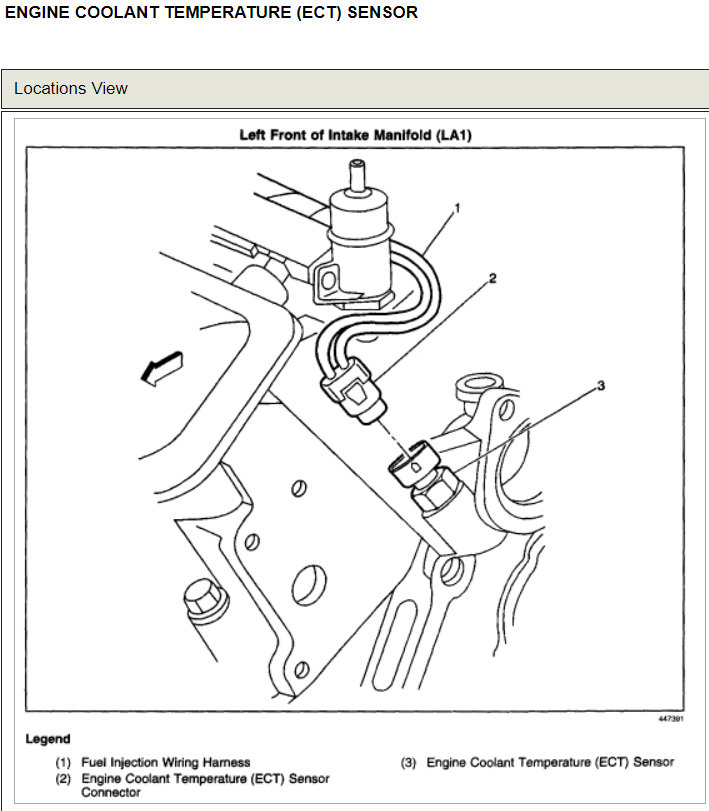

2003 Chevy Impala 6 cyl Front Wheel Drive Automatic
Where is it located? Can it be easily removed and replaced?
Oct 28, 2008 at 9:35 AM
DENNYP
  • 1,824 POSTS
Here is a guide to help you see what you are in for when doing the job.
https://www.2carpros.com/articles/coolant-temperature-sensor-cts-replacement
Here is the location on your car.

Engine Cooling problem
2001 Chevy Impala 6 cyl Two Wheel Drive Automatic 97500 miles
How do you change your coolant sensor, or where can I find out how to go about doing so?
Apr 10, 2018 at 3:57 PM (Merged)
LEGITIMATE007
  • 5,121 POSTS
I have a diagram with the simple instructions and location of the ect,(engine coolant temp sensor)

DNORRIS38
Where is the Engine coolent sensor located?
MERLIN2021
  • 17,250 POSTS
https://www.2carpros.com/forum/automotive_pictures/62217_Impala_Ect_1.jpg
On 3.8 As in diagram:

MICKEY-D
  • 304 POSTS
Could you please give me the location of the coo;ant level sensor for the 3.4 engine?
BLUELIGHTNIN6
  • 16,542 POSTS
engine coolant temperature (ECT) sensor is located near the coolant outlet, on left rear of engine.
