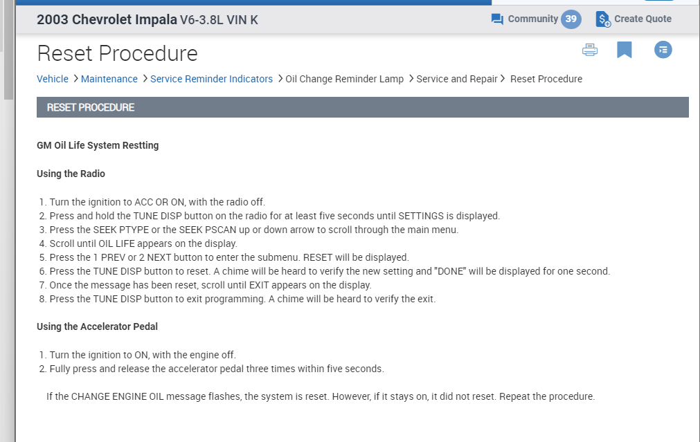

i just got my 03 impala. its a 3.4l v-6 and i already did a tune up..changed motor oil, oil filter,transmission fluid, air filter, plugs, wires, new battery and all of that but i cant figure out how to reset the "change engine oil" light on dash. if any one has the answer i would really appreciate the help because that light really buggs me.. i hate seeing those lights on my dash..
