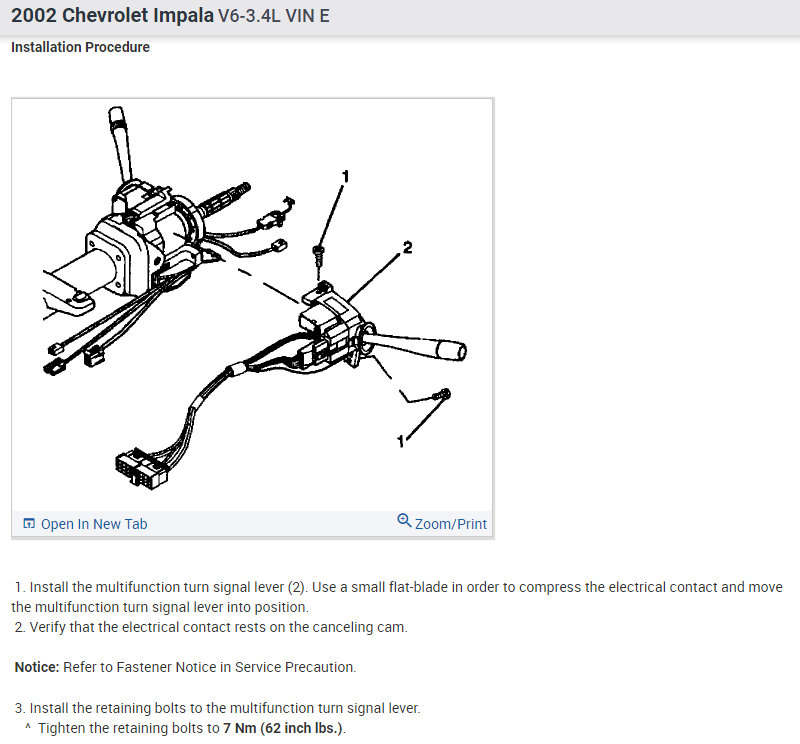

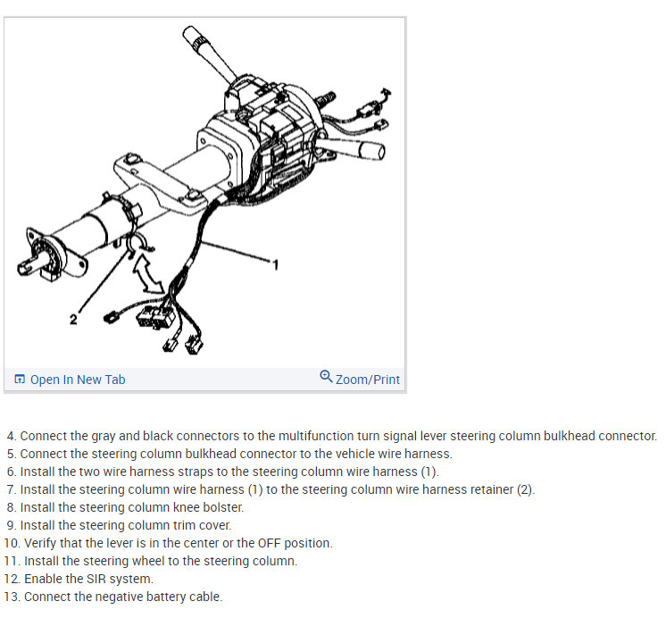

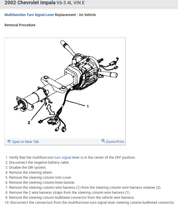

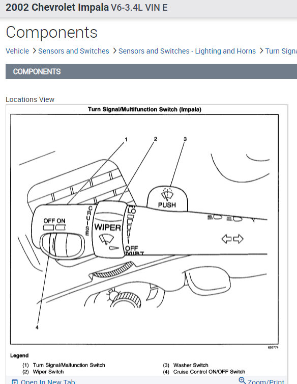

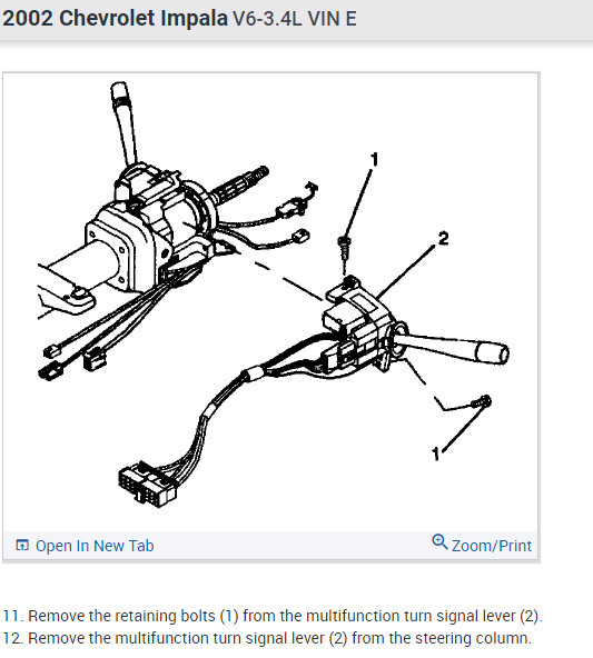

It sounds like you might have a faulty turn signal switch (multi function switch).
Those switches can get worn overtime and will give you intermittent issues.
Replacement of the turn signal switch can be done using simple hand tools in about an hour, depending on your comfort level.
You will have to remove the shrouds around the steering wheel to get to the bolts that keeps the switch in place.
