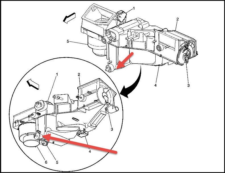

My 2002 Impala is not draining water from AC, where can I find the AC drain Tube?
Jun 6, 2009 at 8:10 PM
The drain tube on these vehicles is going to be found in the engine compartment but it is actually a part of the HVAC housing.
So, I will attach the picture from the manual which will help with this.

Please see the picture attached and let me know if you have other questions.
