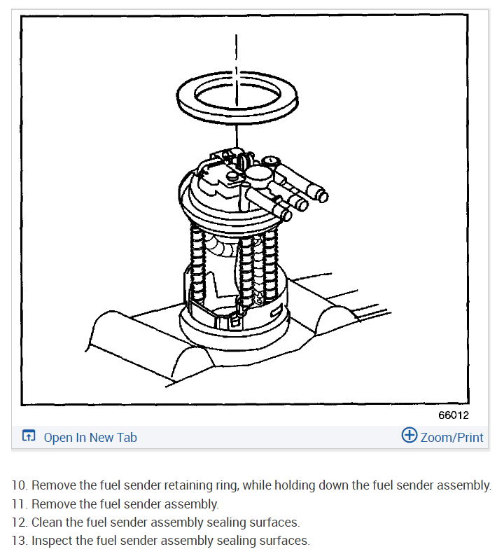

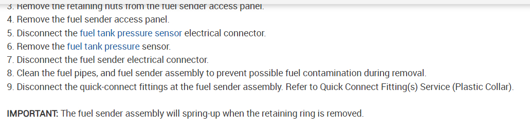

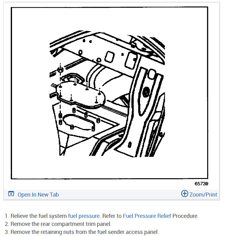

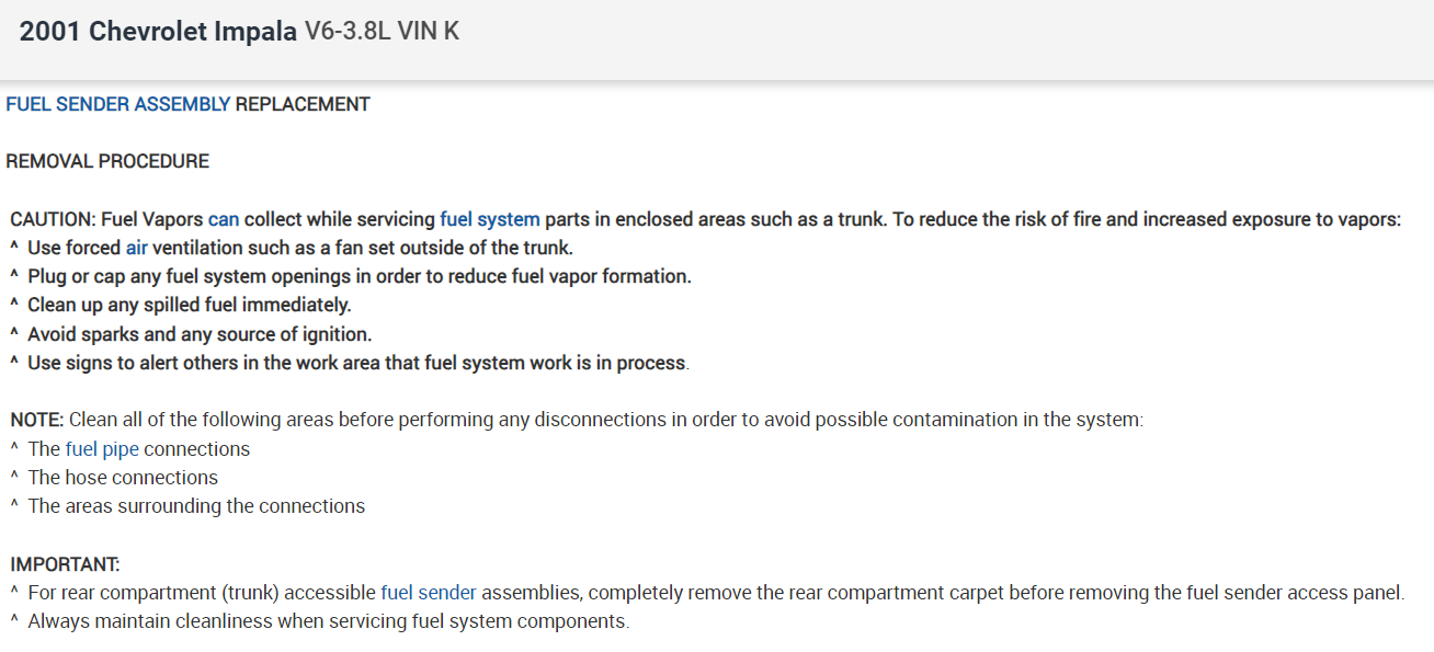

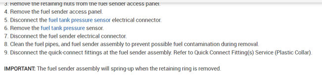

I agree with DENNYP, 9 times out of 10 it will be the fuel level sender hee is how to replace it, I would get a new fuel pump as well because it comes as part of the sender. Luckily the car has a trap door so change the pump and fuel level sender is easy.
