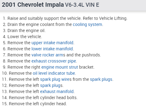

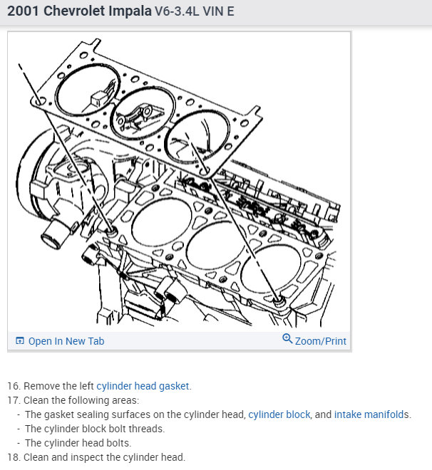

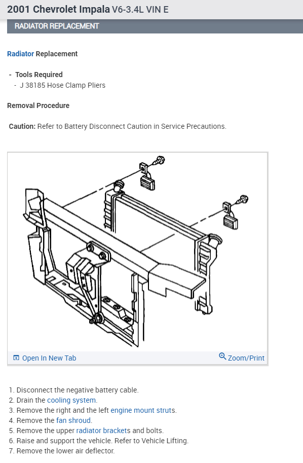

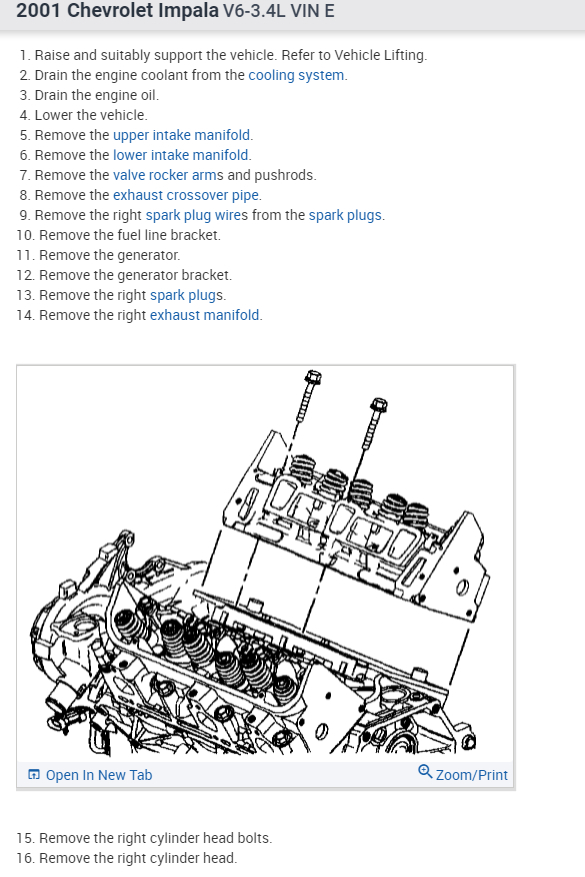

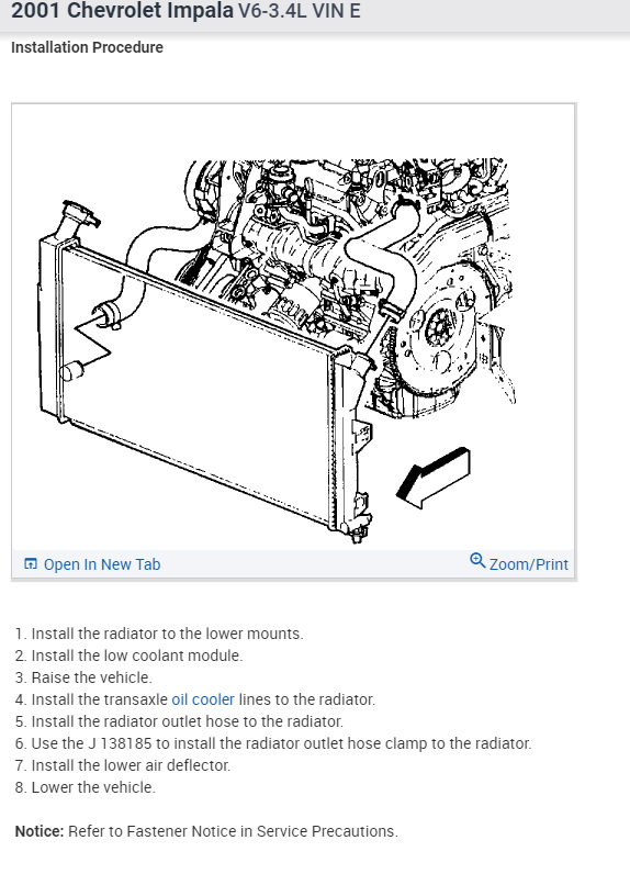

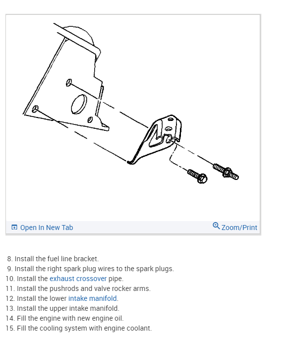

Replacing the head gasket, resurfacing the head and radiator replacement requires decent amount of labor time. Which can make this expensive.
With repair of this size, it is always a good idea to get a second estimate from another shop. That way you can pick the best option for you. Given said that the price quoted is within reasonable amount from data across the country.
https://www.2carpros.com/articles/how-a-cylinder-head-works

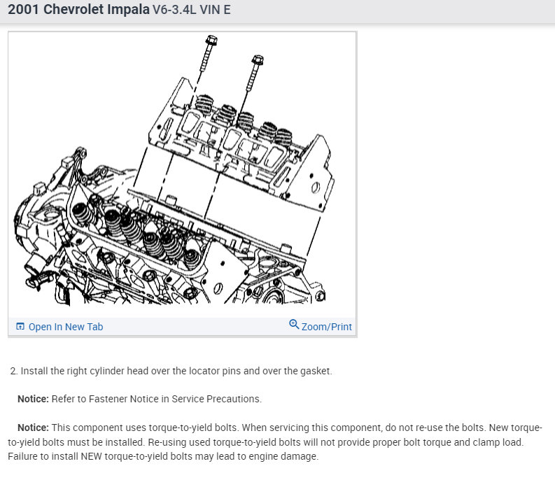

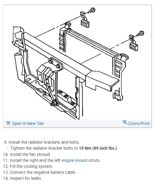

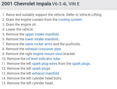

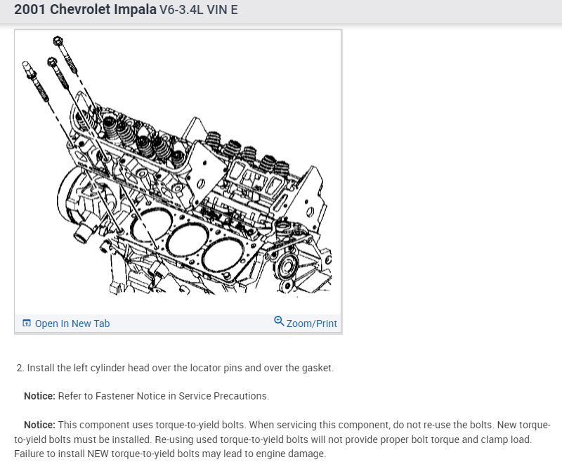

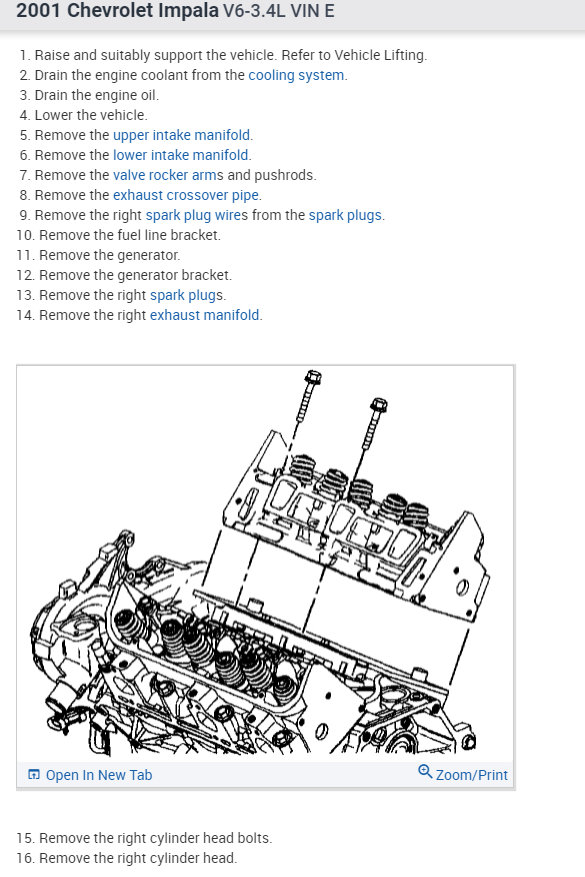

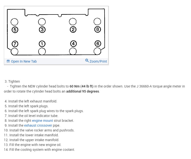

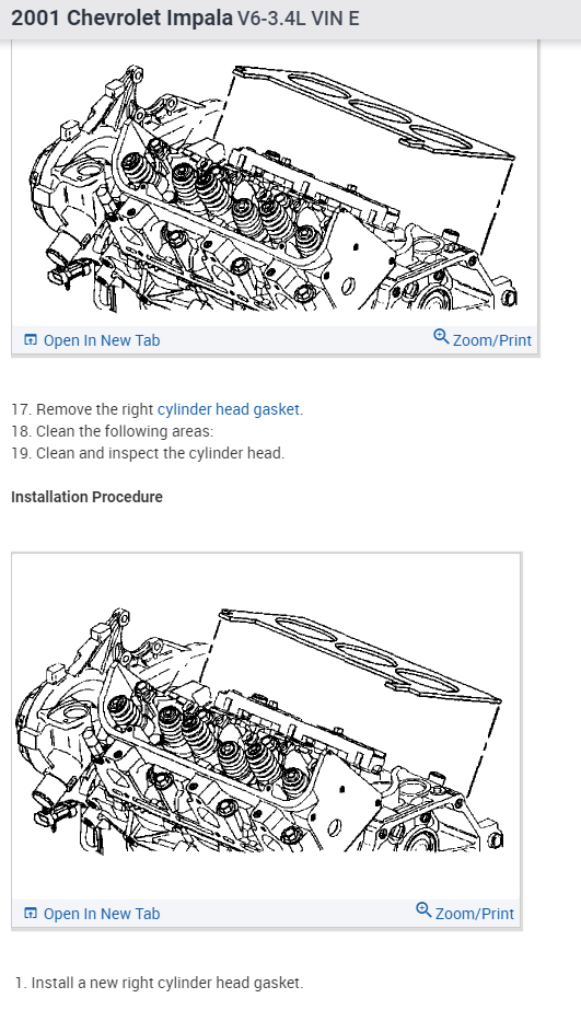

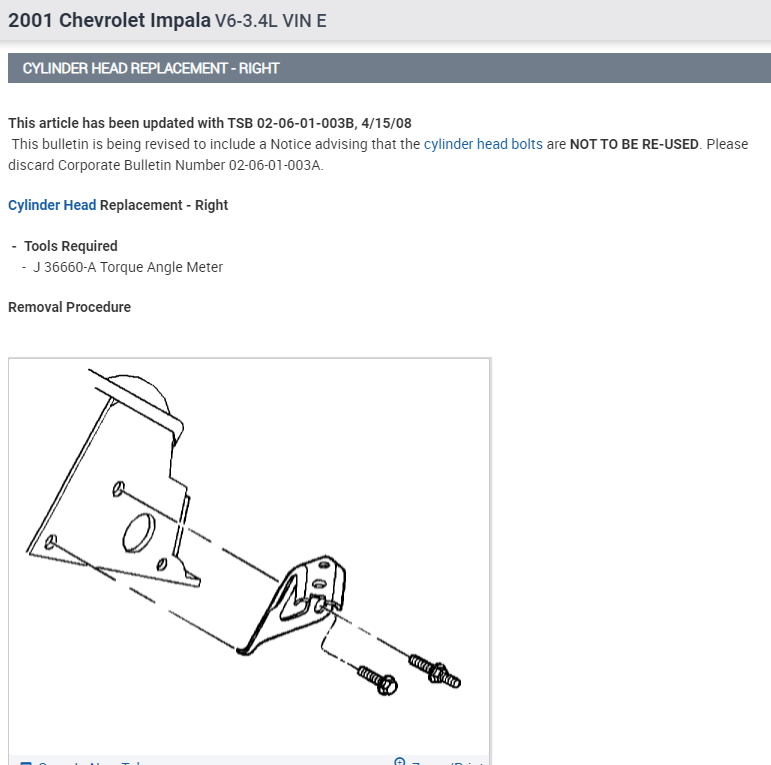

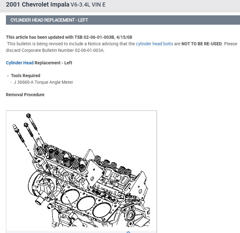

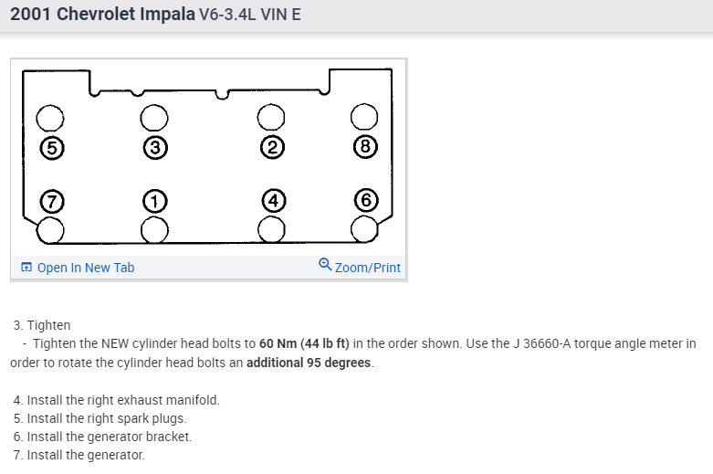

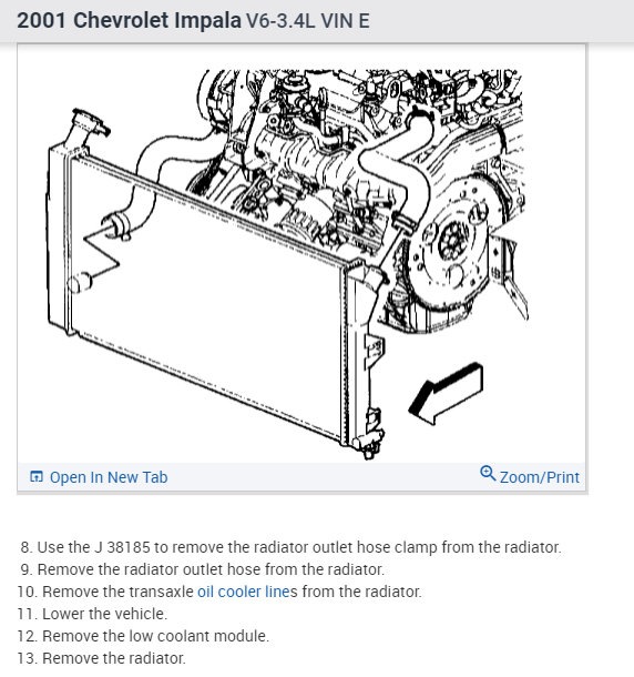

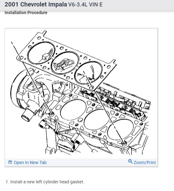

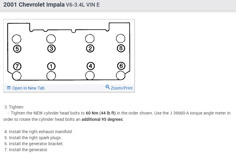

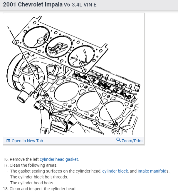

I have attached the replacement procedure below as a reference.
