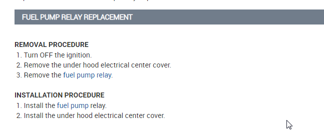

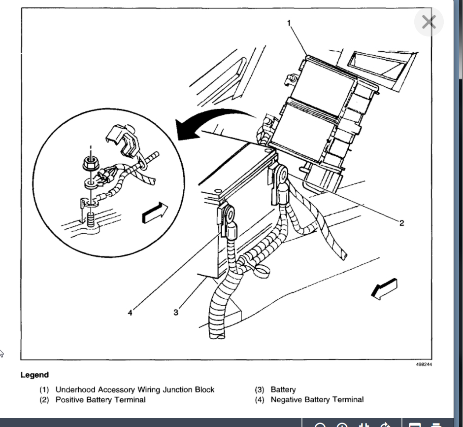

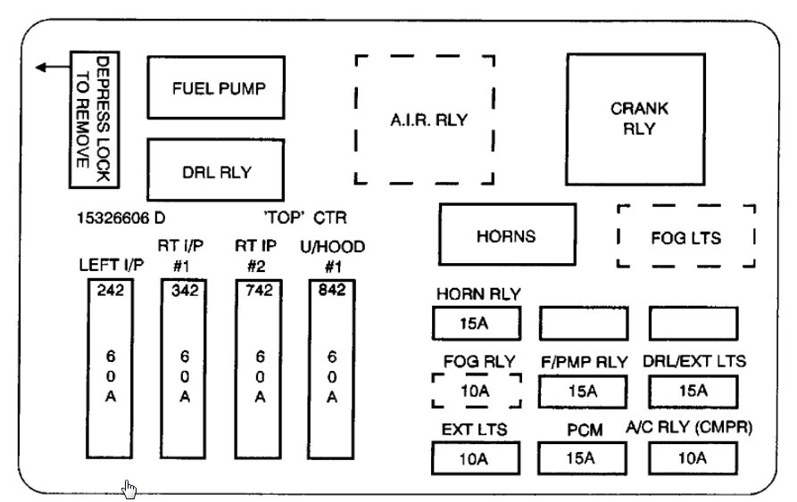

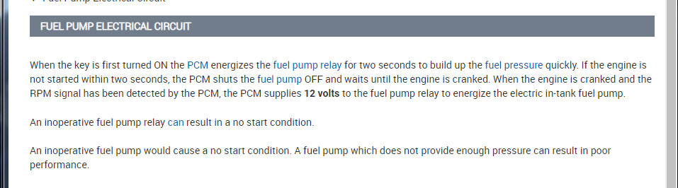

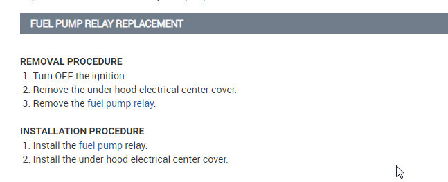

Yes you do. It is in the underhood fuse block. Here is a guide that will help with this:
Below is the info from the manual. Please let us know if you have of questions. Thanks
