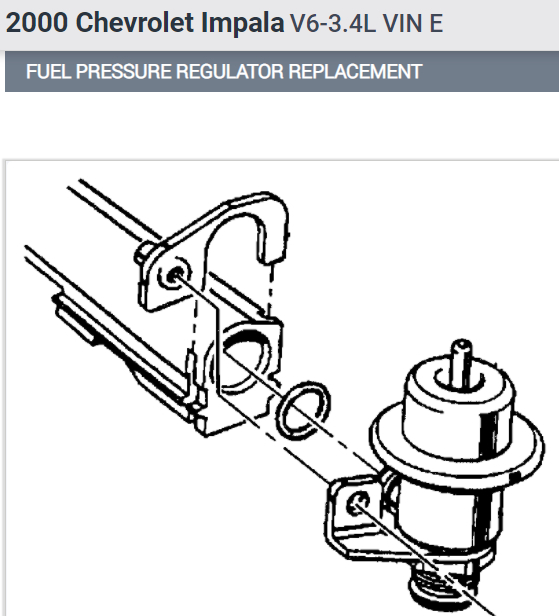

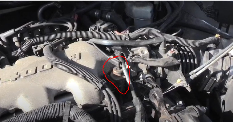

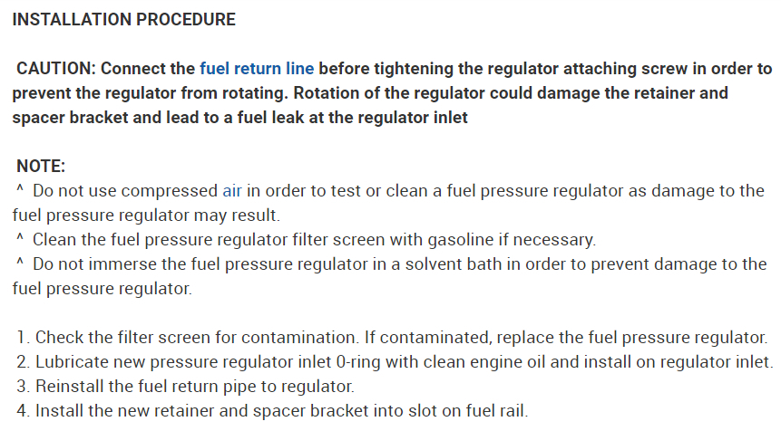

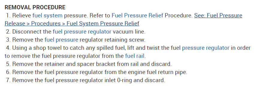

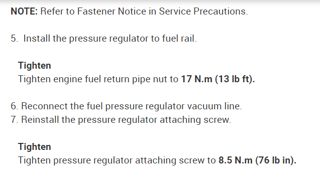

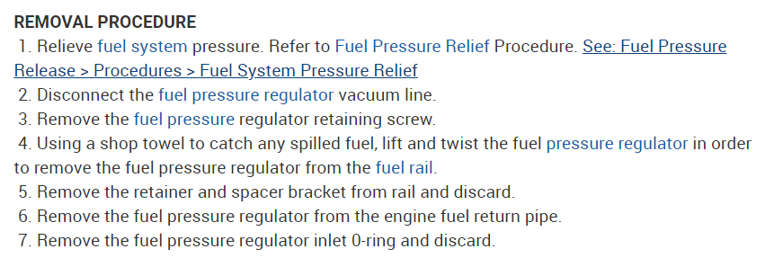

Hello, I'm Danny.

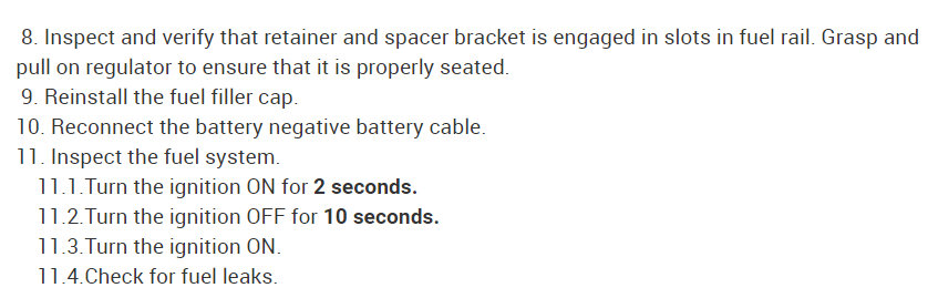

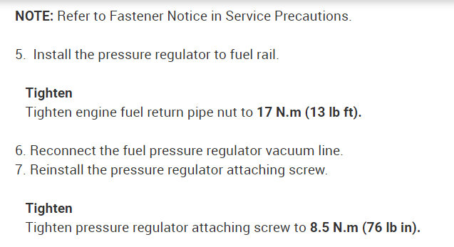

I've attached picture replacement steps below for you fuel pressure regulator on your car. I've also attached a picture below of its location and circled it in red. Hope this helps and thanks for using 2CarPros.
