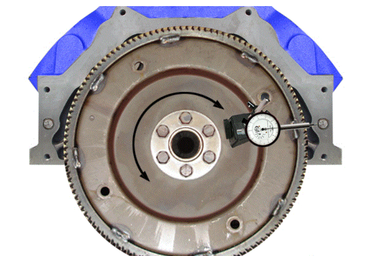

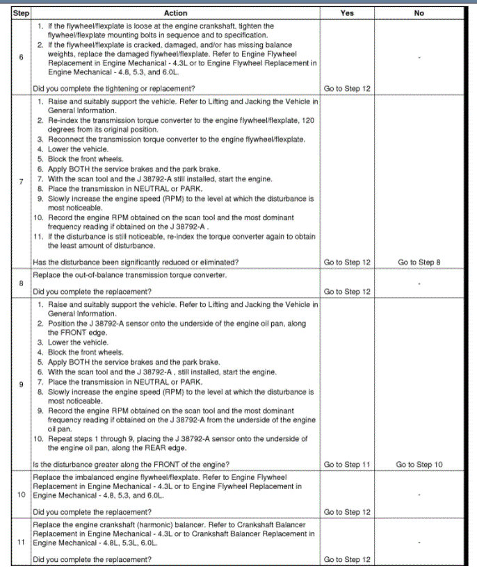

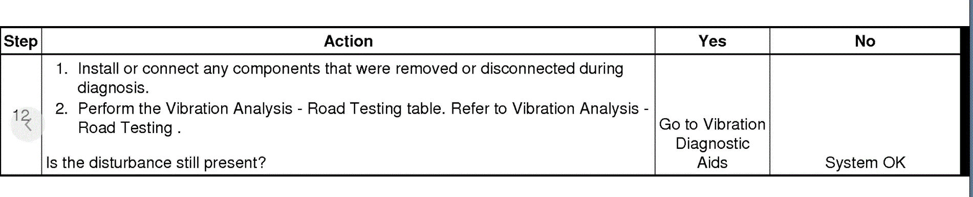

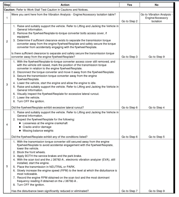

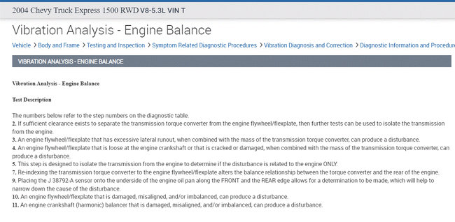

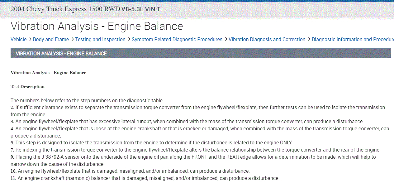

If you look at the attached pic (number 1) it shows how to test for flywheel runout using a dial indicator. The remaining pics, related to vibrations, are for testing for flexplace lateral runout and for issues with the torque converter itself.
Check these things and let me know if you have other questions.
See pics below.
