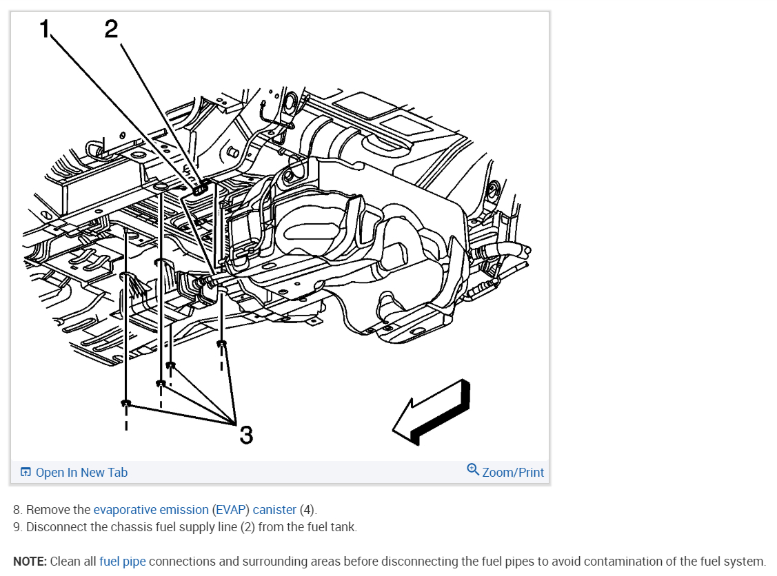

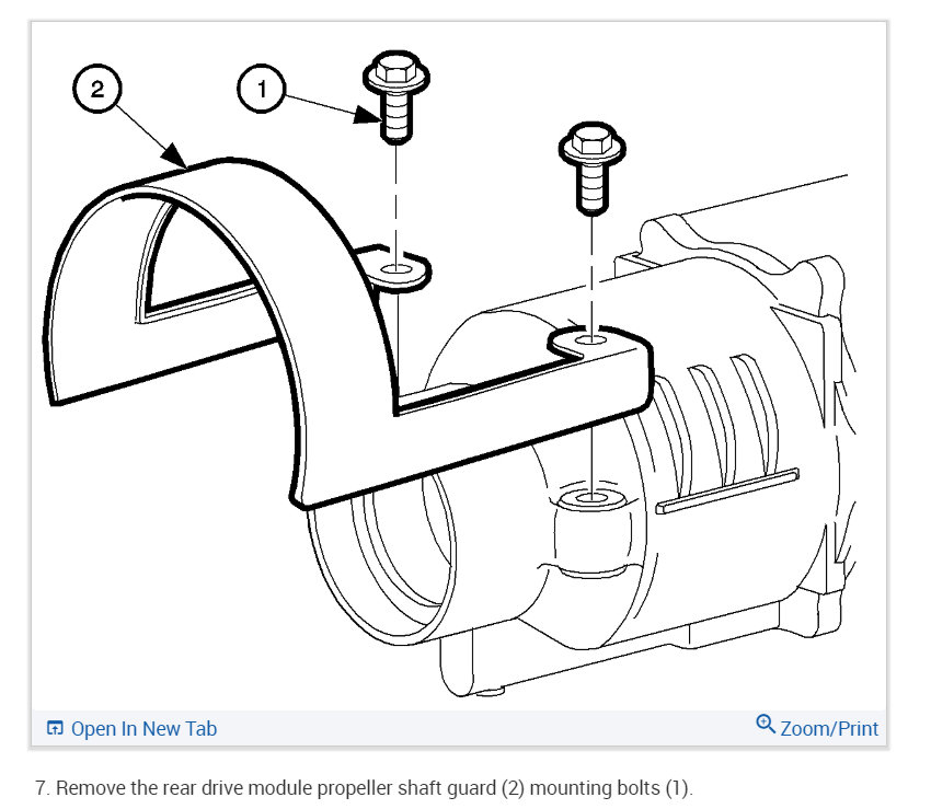

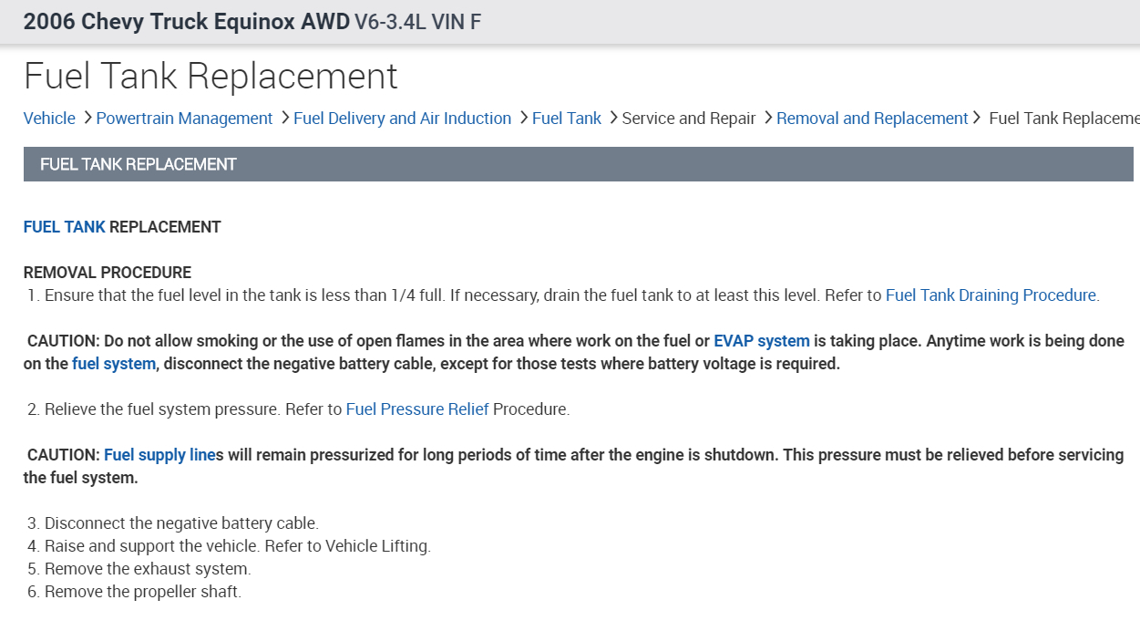

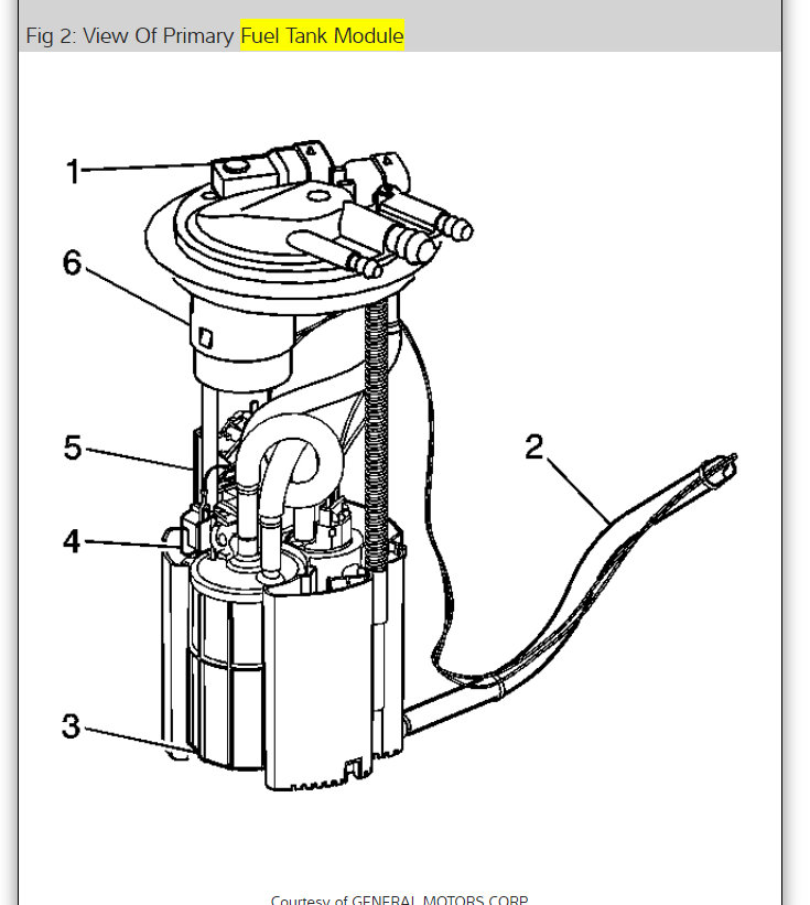

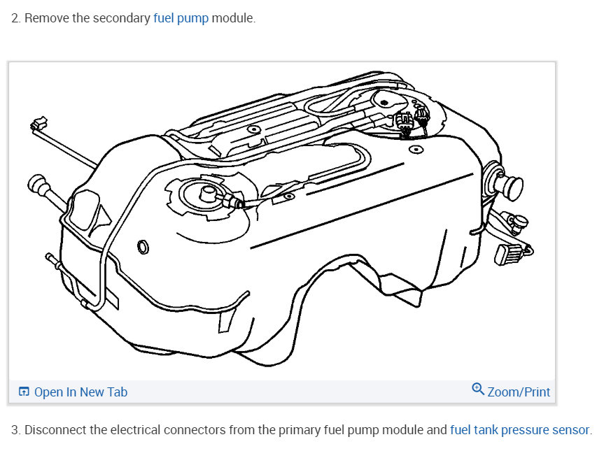

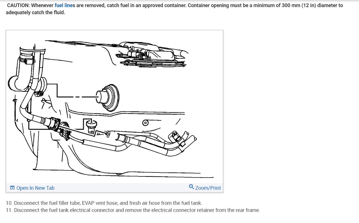

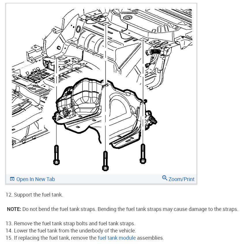

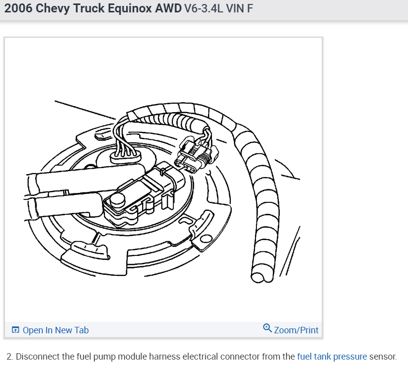

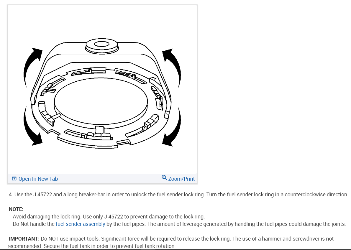

The fuel filter is a non-serviceable type, located inside the gas tank with the fuel pump module. It is not necessary to change the fuel filter unless you are having issues with fuel supply to the engine. Here are diagrams on how to change it. Check out the diagrams (Below). Please let us know if you need anything else to get the problem fixed.
Jan 11, 2010 at 8:39 PM

The fuel filter is in the tank as part of the fuel pump module.
