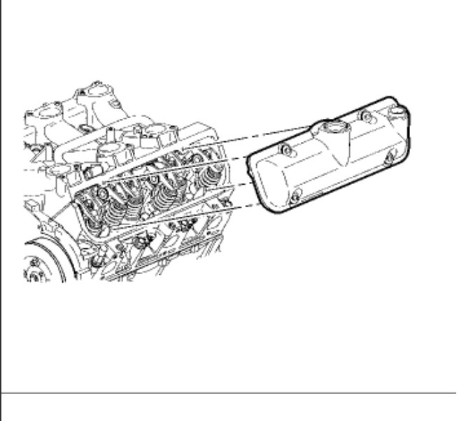

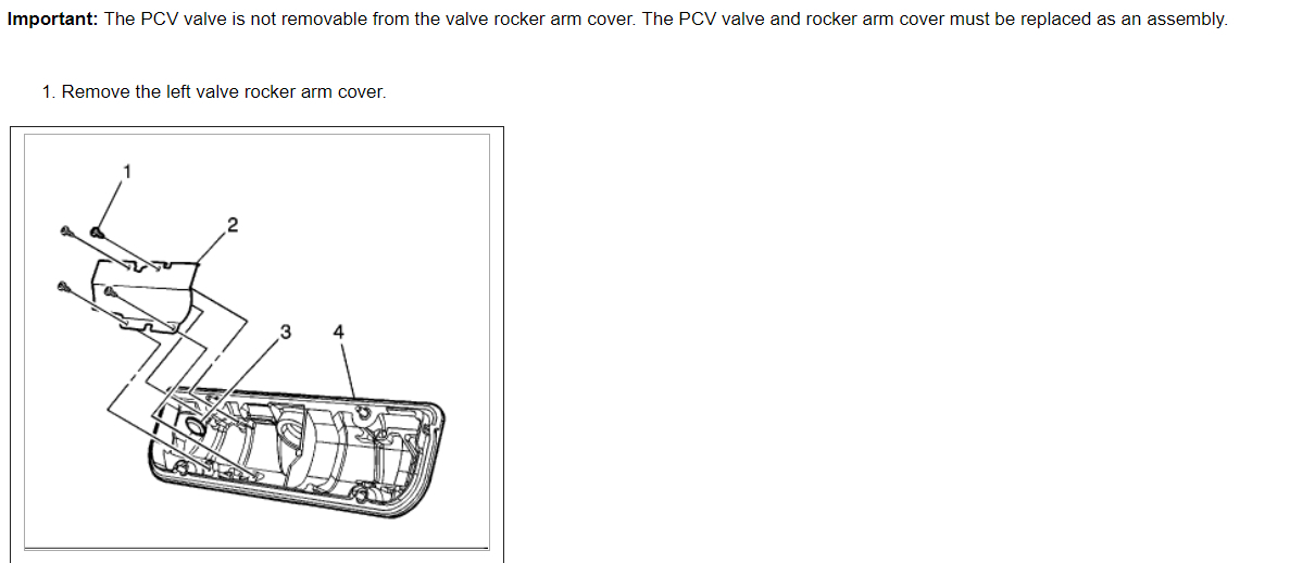

How do you change the PCV valve on a 2005 Chevy Equinox? It appears to have a retainer that holds it in place that is permanently mounted to the engine block.
Jun 21, 2009 at 8:17 AM
Its part of the valve cover, you have to replace the whole valve cover to replace the PCV
