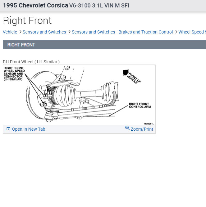

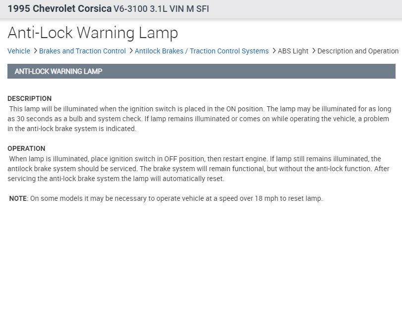

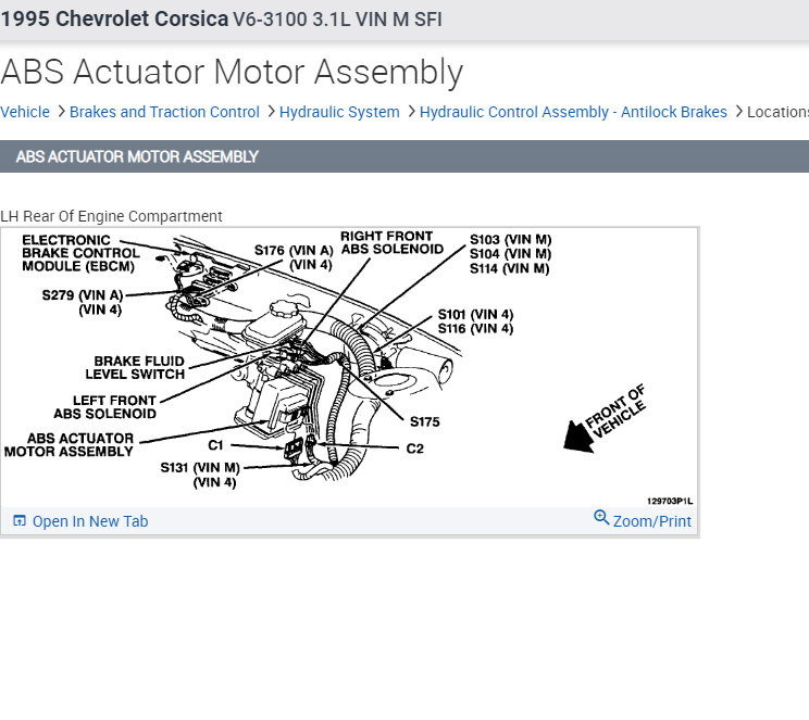

The ABS light gets triggered when the ABS system detects any fault within.
It could be due to a faulty sensor, bad wiring or the module.
https://www.2carpros.com/articles/abs-warning-light-on-easy-repair-guide
The best course of action would be to scan and retrieve the ABS code(s). That can help with the diagnostics of what might be triggering the light.

As for the constant clicking. Where is the noise coming from? Typically, a faulty relay can click.
Do you have any component that is inoperative?
You might have to look at the fuse panel inside the vehicle to see if you can determine which relay is clicking.
