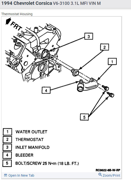

The thermostat is inside the thermostat housing, which is installed by 2 screws.

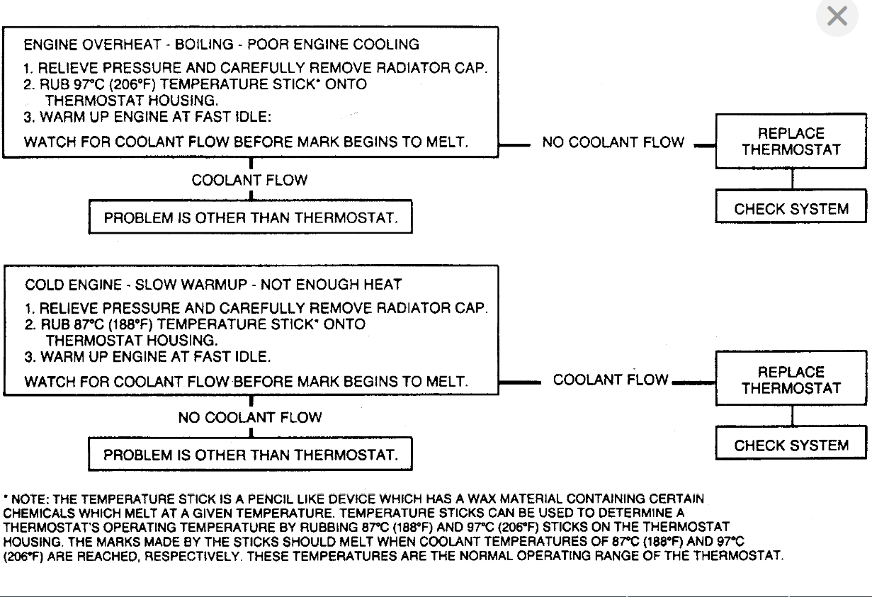

I have attached thermostat replacement procedure for your reference.
