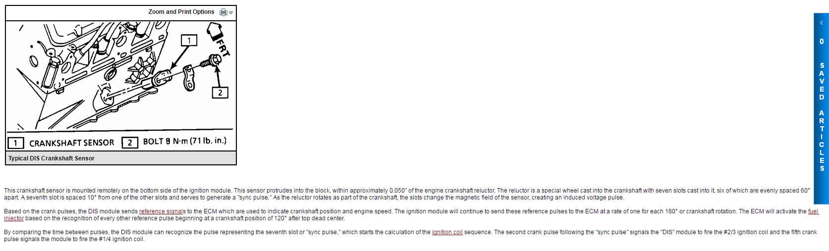

Researching the problem seems to indicate the crankshaft position sensor to be the problem. (The car has been riding low and bottoming out due to a need to replace the struts... I believe this may have led to the sensor becoming damaged)
I would appreciate any opinions and advice regarding this problem. I would also appreciate any diagrams and information about where the part is located and how to replace it.... I am a DIY mechanic and unable to take it to a garage. So I need to fix this myself.
