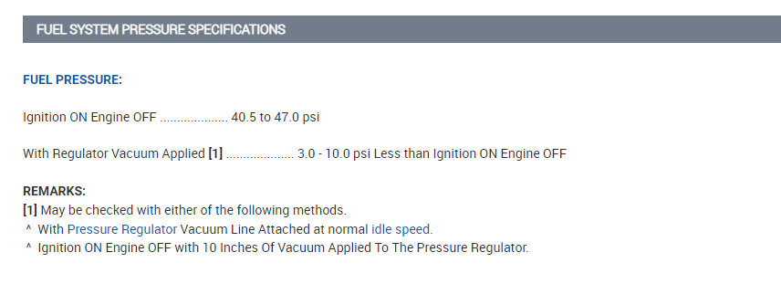

More than like the issue is the fuel pressure regulator.
If you are testing the fuel pressure and it is lower then needed then most likely the regulator is leaking causing the pressure to drop.

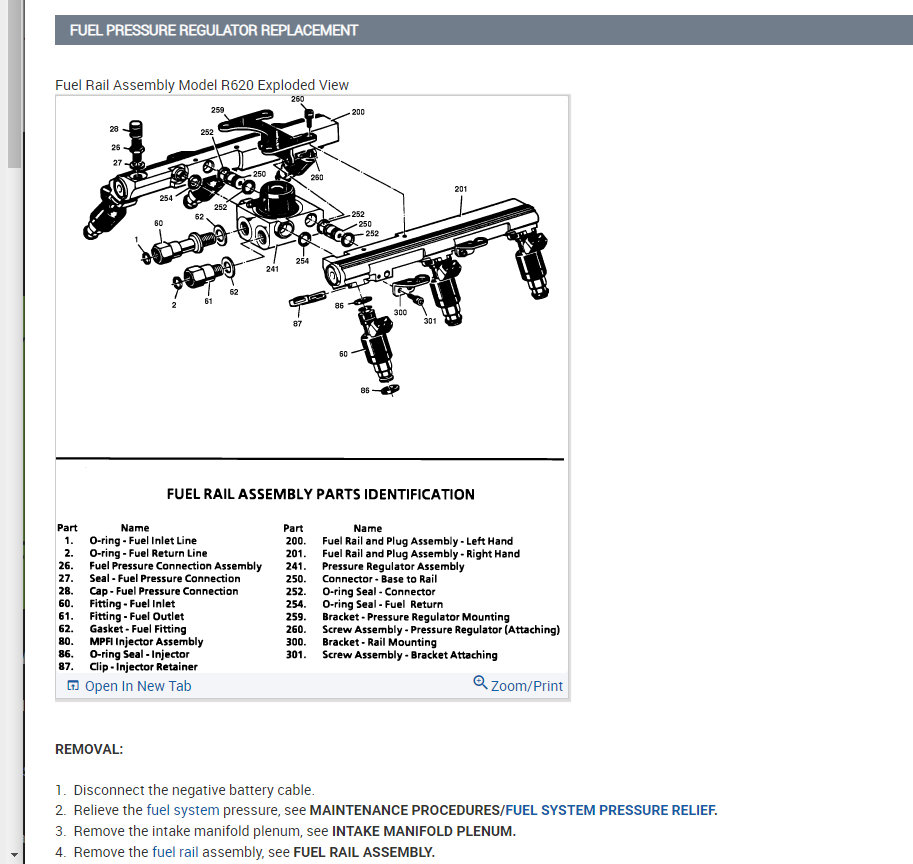

Please consult this guide for more info:

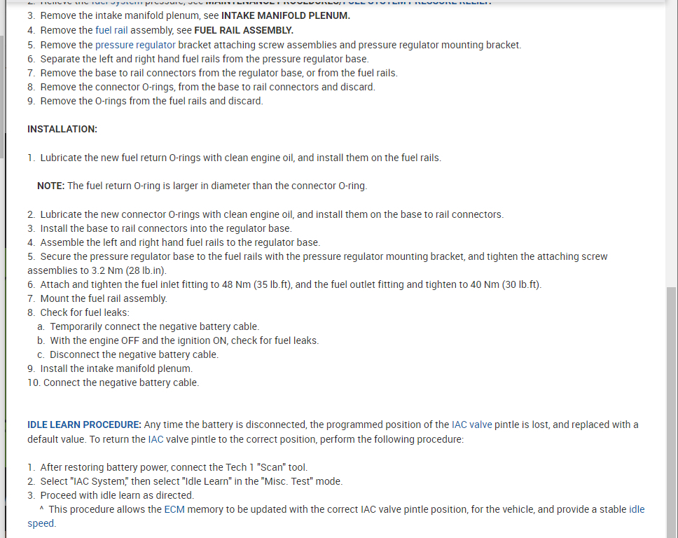

Below you will find the process from the manual that will help with getting this replaced.
Please let us know how it works out and we can go from there. Thanks
