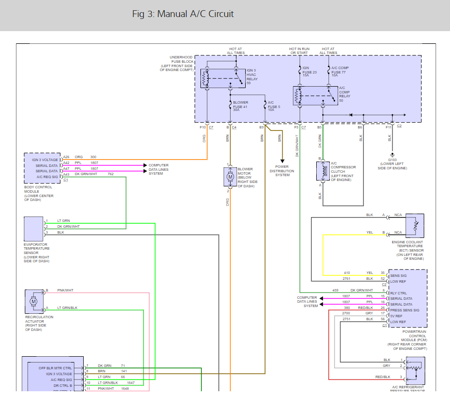

It sounds more like the blower motor is not working right. Here is a guide to help you test the blower motor and replace it is found to be bad.
https://www.2carpros.com/articles/blower-fan-motor-works-on-high-speed-only

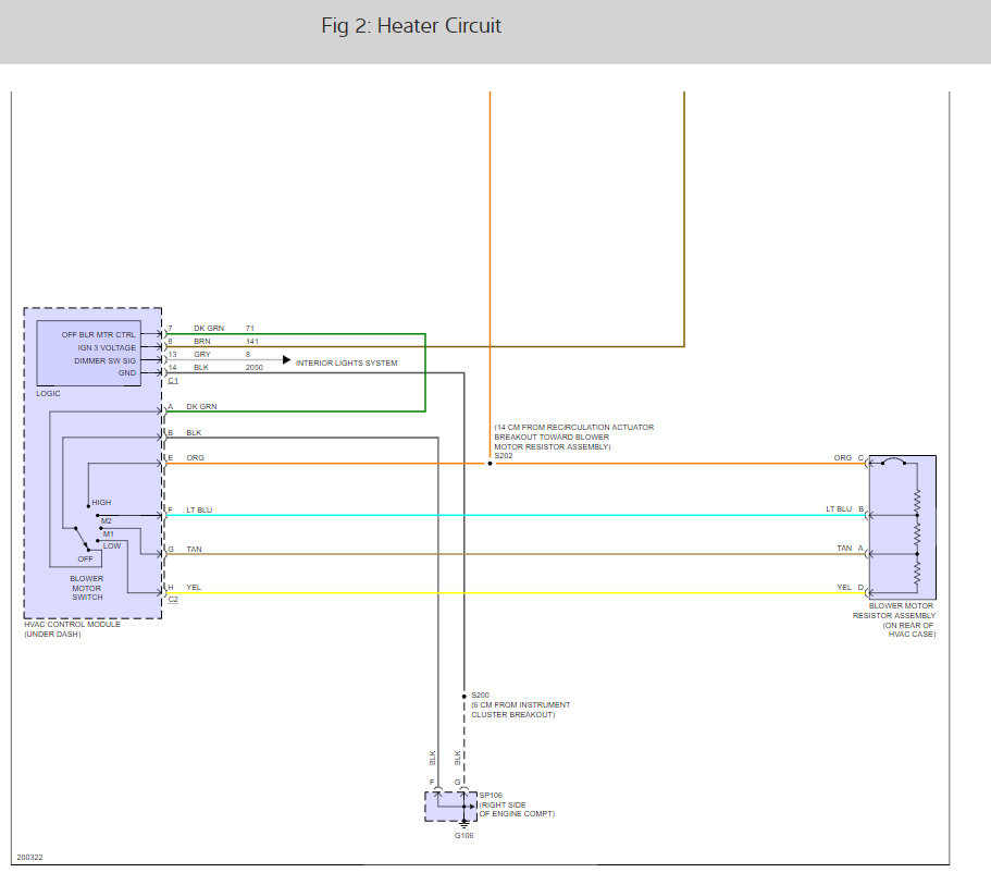

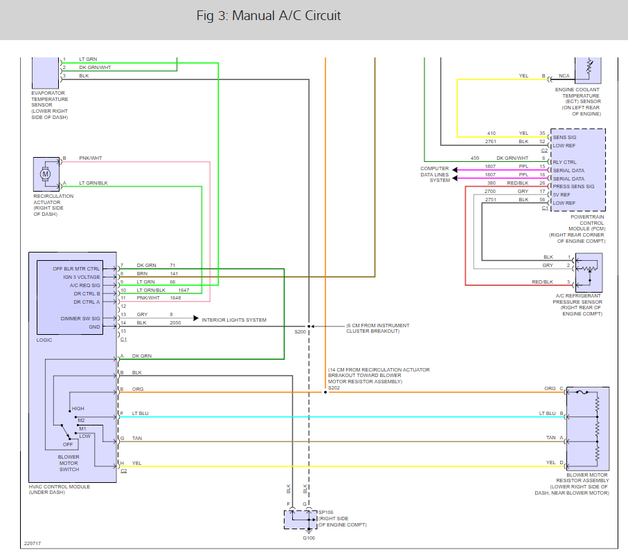

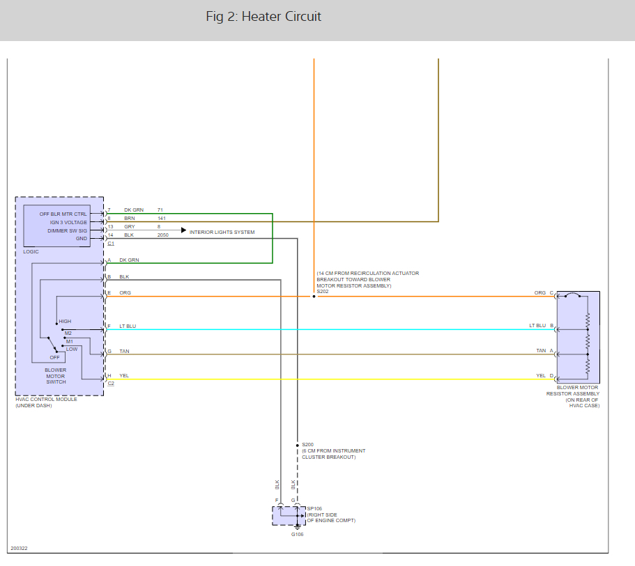

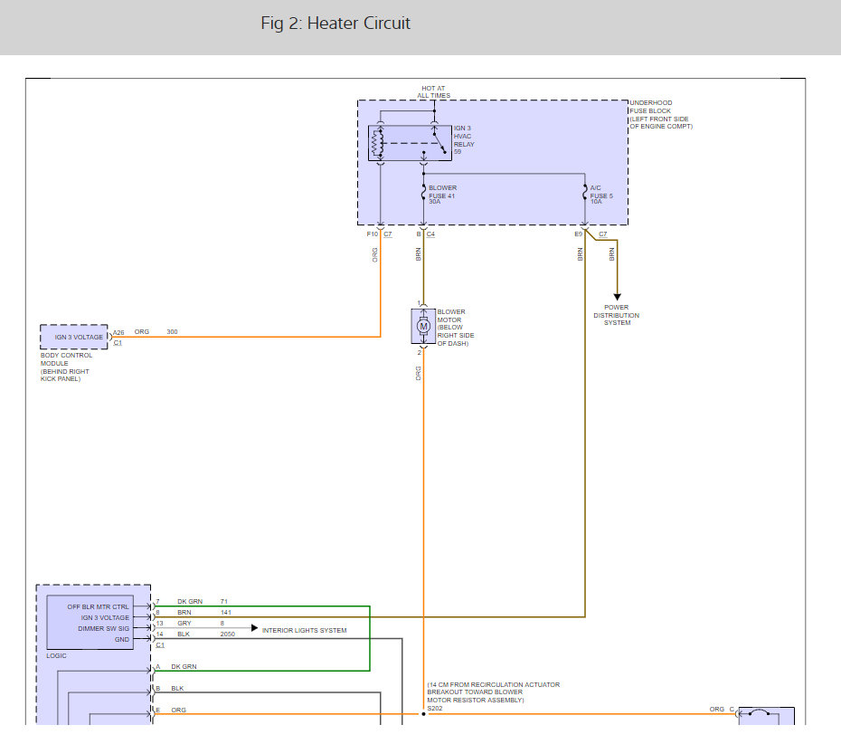

Here is a wiring diagram for the blower motor system so you can see how the system works (below)
Feb 3, 2018 at 11:44 AM
PAPA JOHN
Thanks for the wiring diagrams! it was the blower motor once I replaced it everything works great again :) thanks for your help.
