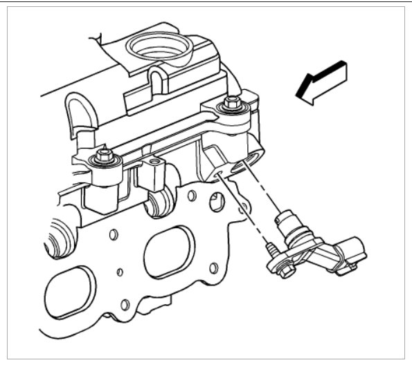

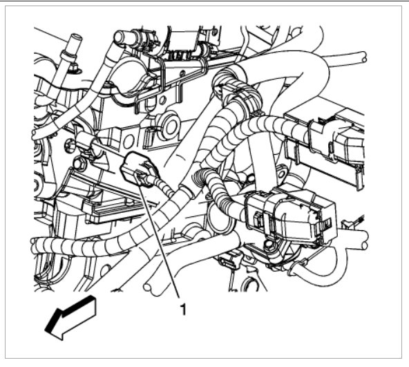

* Camshaft Position Sensor Replacement - Intake
* Crankshaft Position Sensor Replacement
