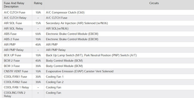

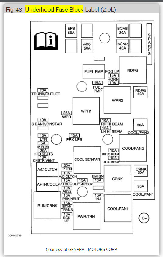

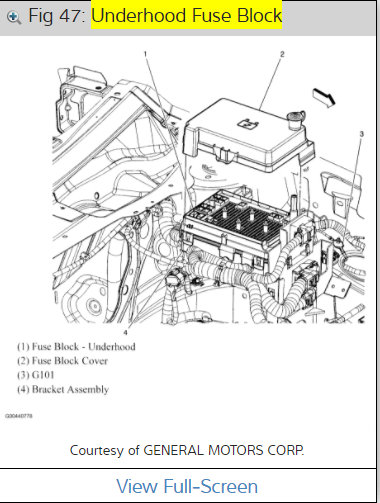

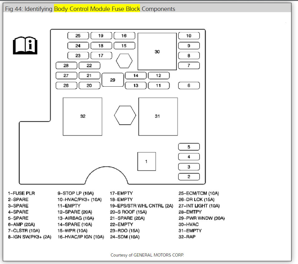

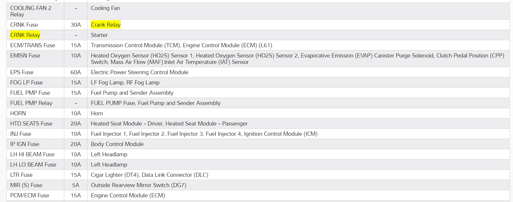

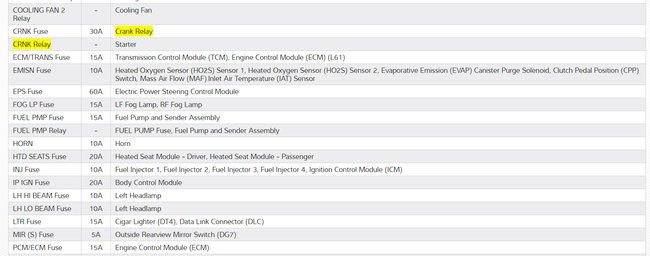

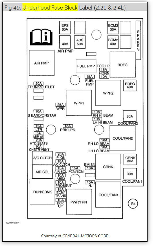

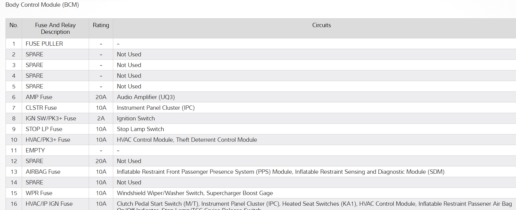

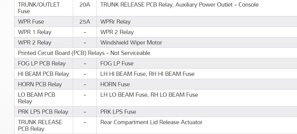

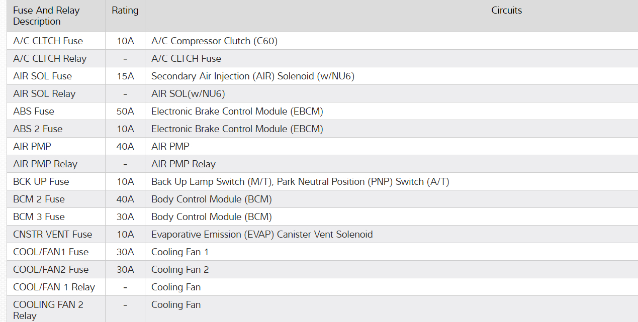

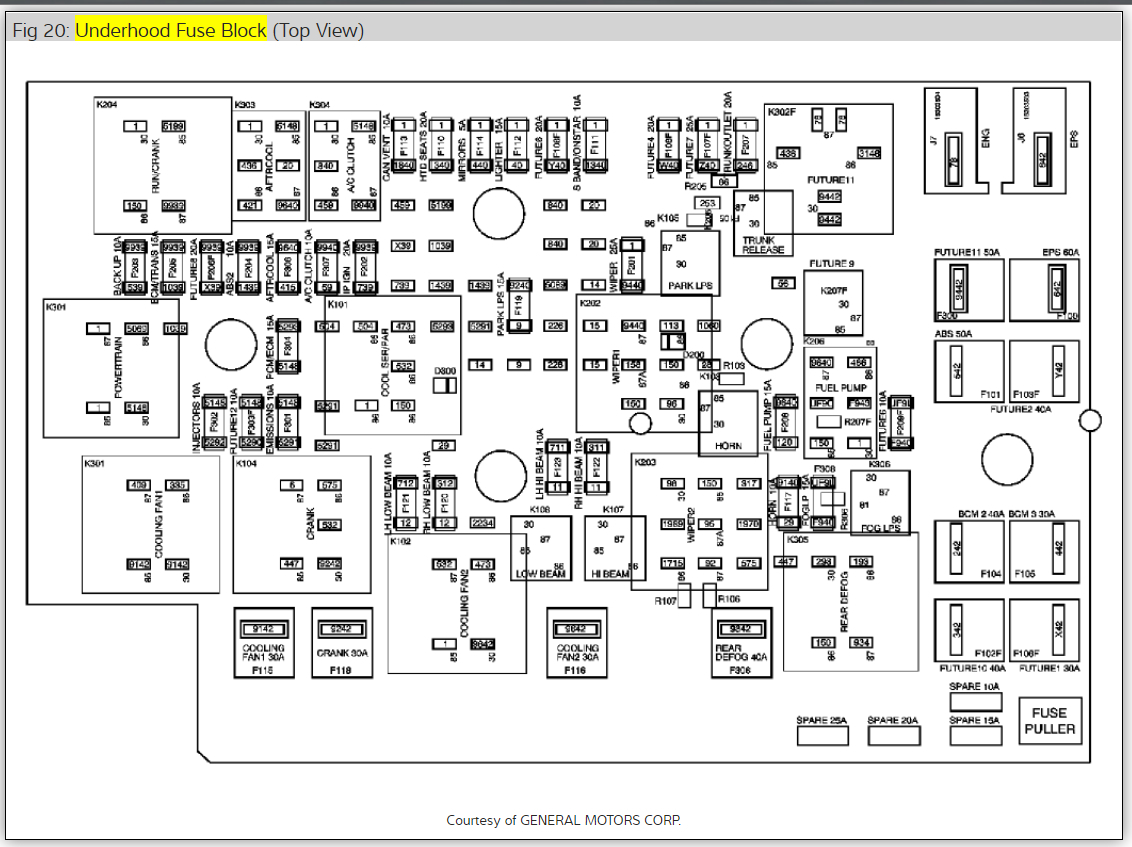

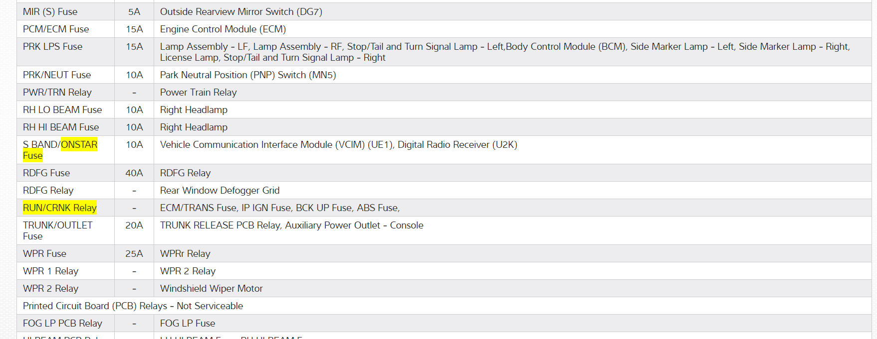

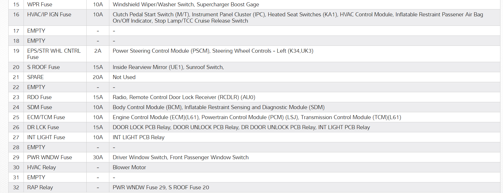

This sounds like you had a voltage surge when jumping the battery that weakened a fuse did you check them all? Here is a guide to help us guide started:
Check out the diagrams (below).
Please let us know what you find.

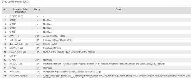

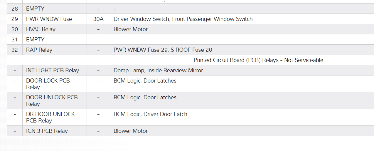

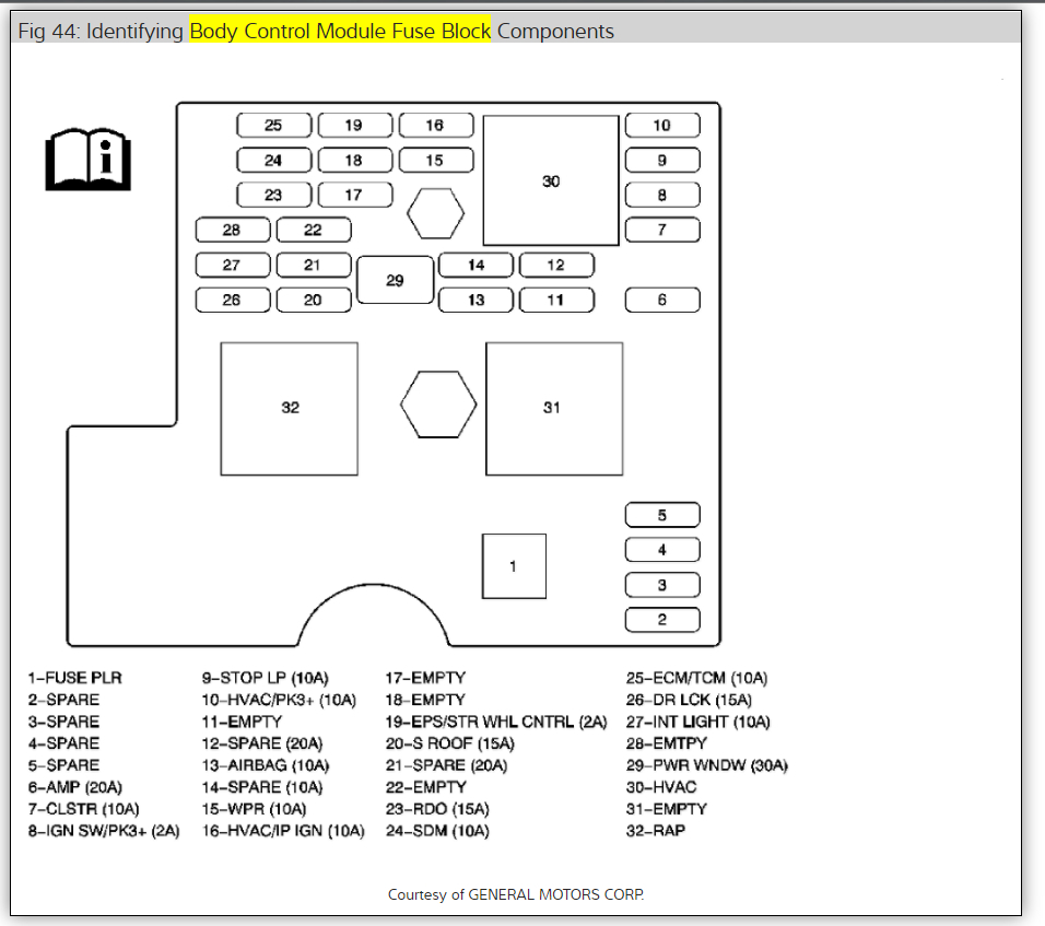

Yes, if fuse ignition switch/PK3 in BCM located under center dash right side console.
Jul 17, 2018 at 11:15 AM
ERICSCHROEDER
  • 4 POSTS
I checked the fuse and I replaced it with a spare. Now the car starts and runs great Thanks 2Carpros, I love this site.
