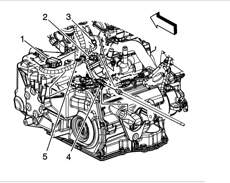

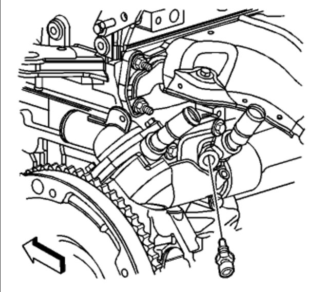

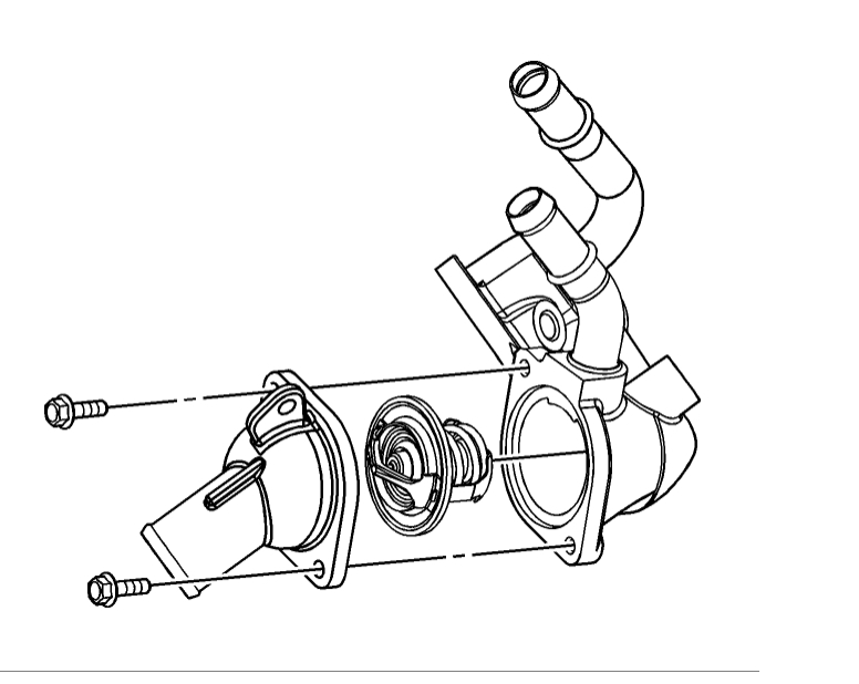

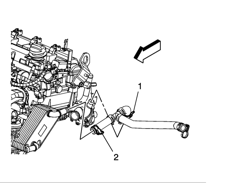

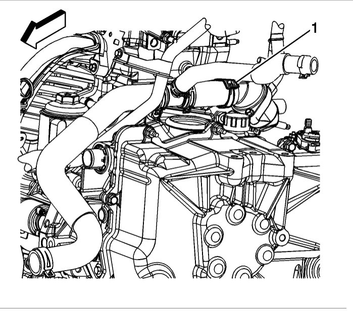

This sounds like a stuck thermostat so I will give you instructions on both. Here is a guide for the sensor that will give you and idea on what you are in for when doing the job.
https://www.2carpros.com/articles/coolant-temperature-sensor-cts-replacement
and
Here is the sensor on Amazon for $9.00 AC Delco
https://www.amazon.com/gp/product/B000CGM9O2/ref=as_li_qf_sp_asin_il_tl?ie=UTF8&tag=2carprcom-20&camp=1789&creative=9325&linkCode=as2&creativeASIN=B000CGM9O2&linkId=805f03af74e6b9da40a401896cac12a2
and the thermostat for $18.00
https://www.amazon.com/gp/product/B000IYT1NK/ref=as_li_qf_sp_asin_il_tl?ie=UTF8&tag=2carprcom-20&camp=1789&creative=9325&linkCode=as2&creativeASIN=B000IYT1NK&linkId=d30fab6bff064f6635c722f18549eae0
Here are some diagrams to help you get the job done on your car (below)
Please let us know what you find.

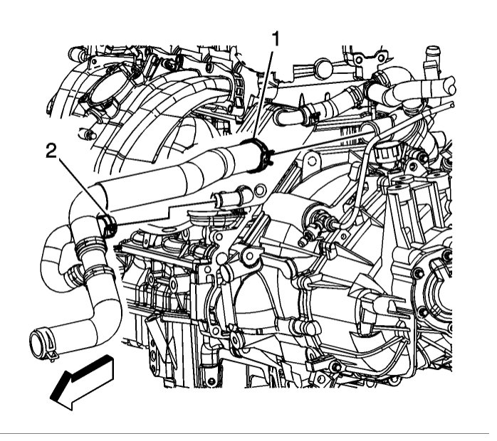

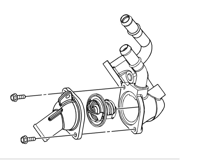

thats the jist of it , getting to it is the ...not really the hard part but the time consuming part. here are some instructions to help .. Removing the intake manifold cover: Remove the engine oil fill cap. Grasp the intake manifold cover by the lower right inboard corner and pull up to disengage the cover from the stud. Grasp the intake manifold cover by the upper left corner and pull up to disengage the cover from the stud. Remove the intake manifold cover. Drain the cooling system. Reposition the radiator outlet hose clamp at the thermostat cover. Remove the radiator outlet hose from the thermostat cover. Reposition the radiator surge tank outlet hose clamp at the thermostat cover. Remove the radiator surge tank outlet hose from the thermostat cover. Reposition the radiator outlet hose clamp (1) at the thermostat cover. Remove the radiator outlet hose from the thermostat cover. Remove the thermostat cover bolts and cover. Remove the thermostat. Remove and discard the thermostat cover O-ring seal.
https://www.2carpros.com/forum/automotive_pictures/261618_1_199.jpg
https://www.2carpros.com/forum/automotive_pictures/261618_2_129.jpg

Thanks you the thermostat seemed to do the trick it is all fixed, thanks a million guys, this site rocks.
