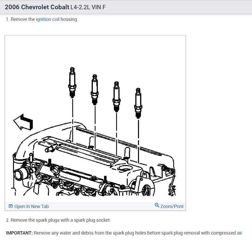

remove the coil housing from the top of the engine, then remove the spark plugs. Use only AC Delco spark plugs. Here is a video to help you
https://youtu.be/xyqOo5MhgGk
SPARK PLUG TYPE
GM P/N .................... 12569190
A/C/ DELCO .................... P/N 41-981
This guide can help as well
https://www.2carpros.com/articles/how-to-change-spark-plugs

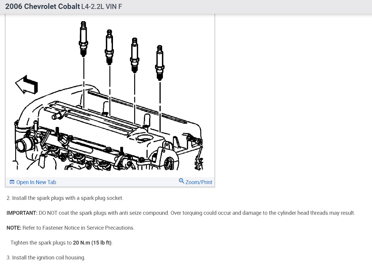

https://www.2carpros.com/forum/automotive_pictures/147643_spark_plug_1.jpg
Remove the ignition coil housing.replace the plug with OEM plugs,too many problems with aftermarket plugs.
