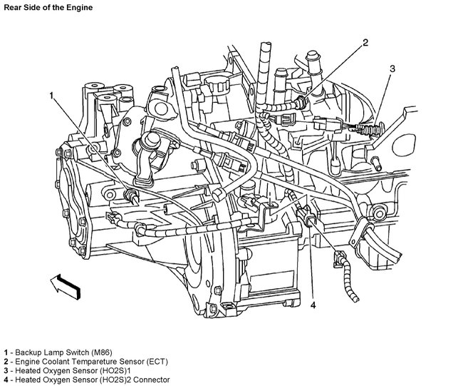

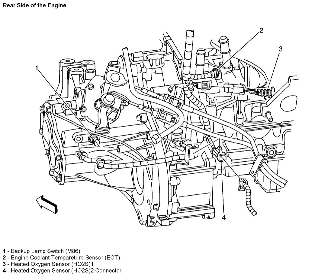

Where is the O2 sensor located at on this car?
Jun 28, 2010 at 12:34 AM
SATURNTECH9
  • 30,869 POSTS

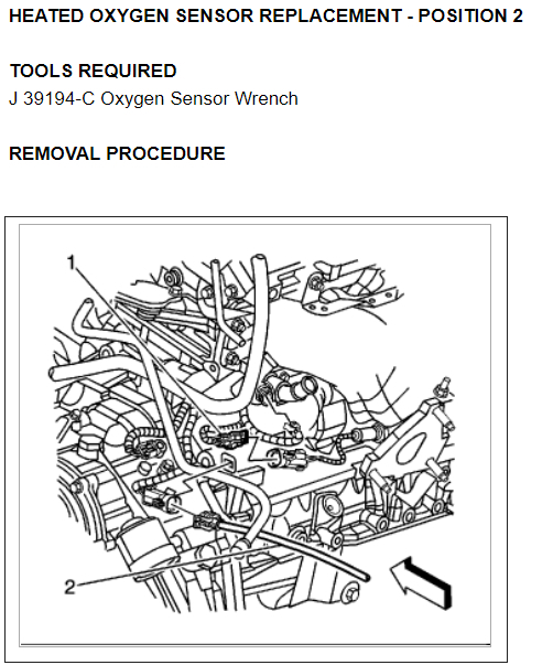

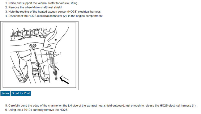

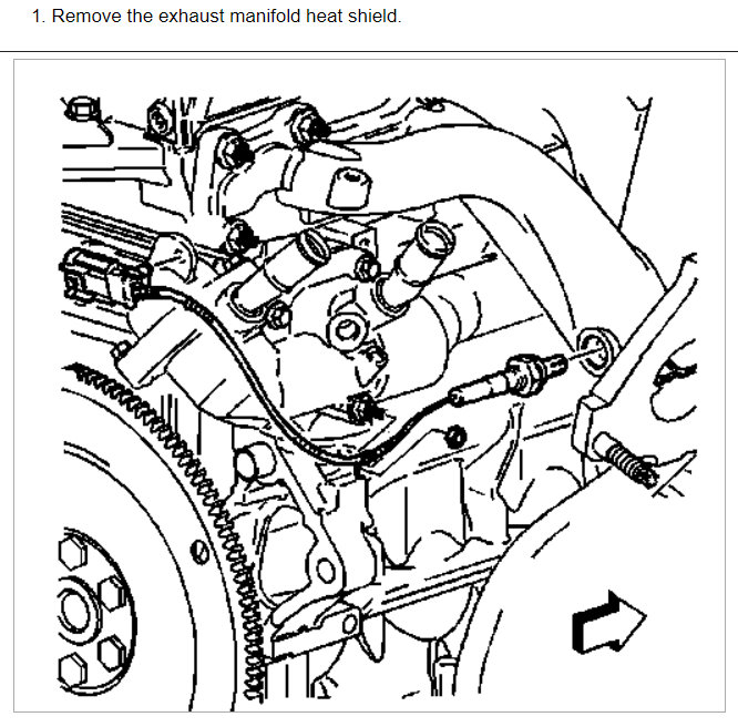

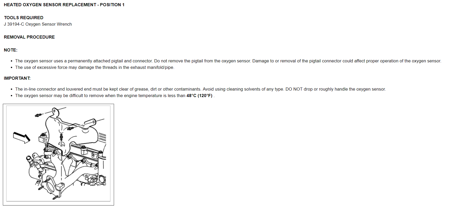

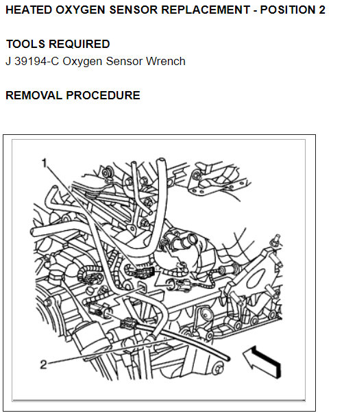

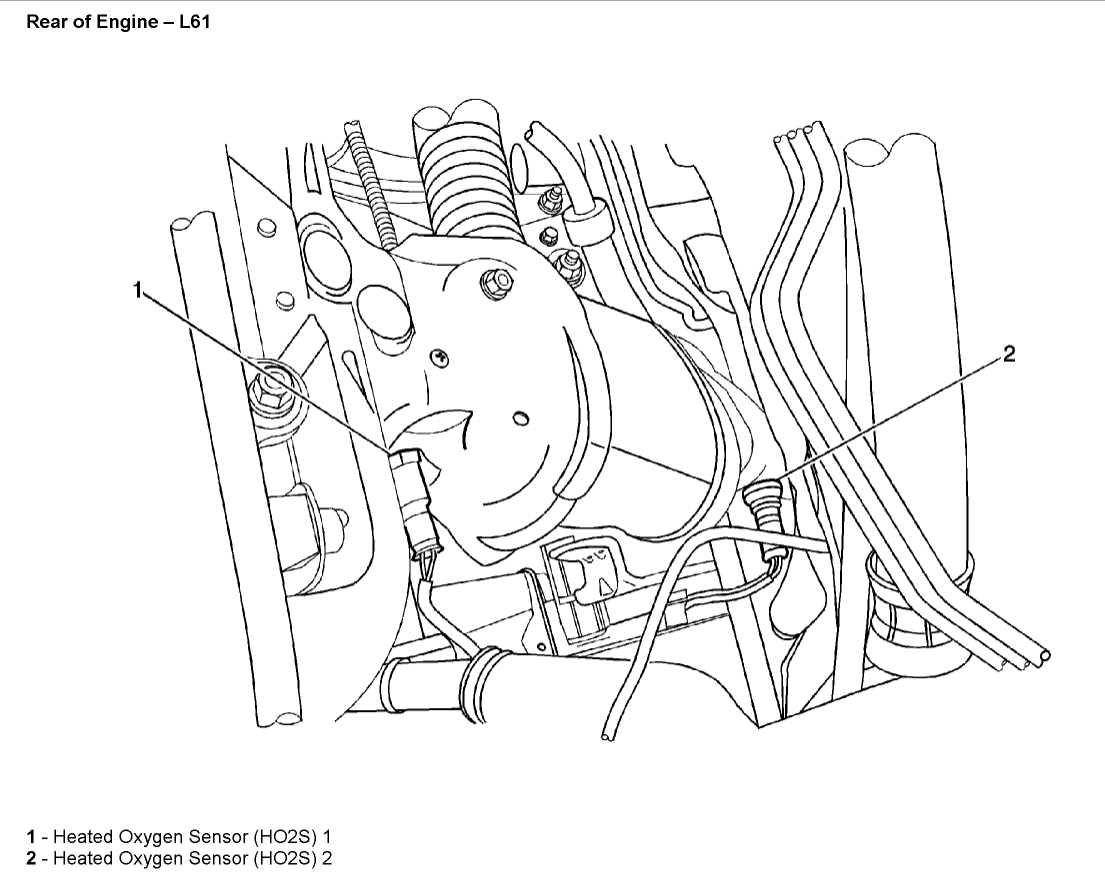

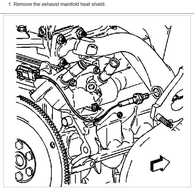

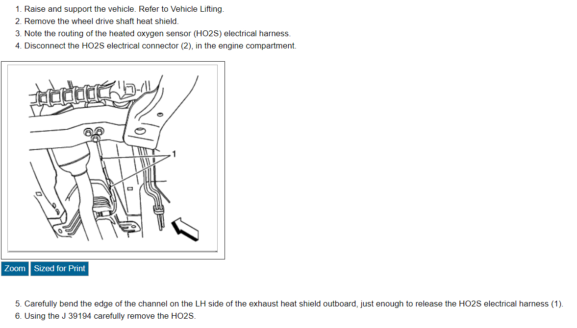

The upstream/o2 sensor 1 is screwed into the exhaust manifold.The down stream/o2 sensor 2 is screwed into the exhaust pipe right before the cat.
Here is a guide and diagrams below to show you how to change both sensor positions.
https://www.2carpros.com/articles/how-to-replace-an-oxygen-sensor
Cheers
Jun 28, 2010 at 12:39 AM
BLUELIGHTNIN6
  • 16,542 POSTS
your vehicle has 2 oxygen sensors, one in rear of engine compartment, in exhaust manifold and the other in rear of engine compartment in the exhaust piping near catalytic converter
