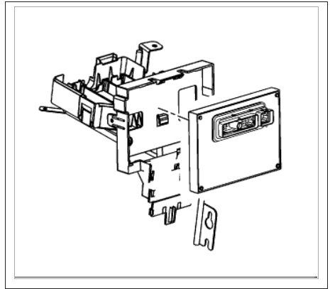

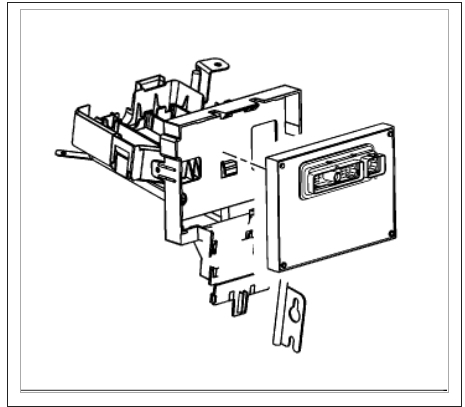

Use the retaining tab to secure the ECM, when installing the ECM to the underhood junction block bracket. NOTE: Control module damage may result when the metal case contacts battery voltage. DO NOT contact the control module metal case with battery voltage when servicing a control module, using battery booster cables or when charging the vehicle's battery.

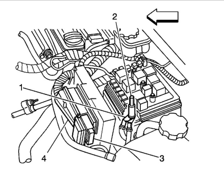

Here is the location of the PCM (Below)
