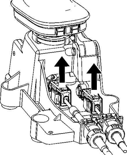

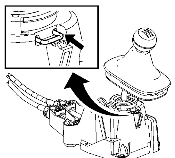

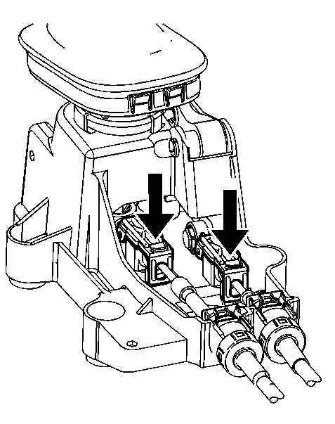

if it worked ok prior to replacing clutch the cable for shifting may be out of adjustment or something got bent in shifter mechanism at trans.
remove cup holder, put shifter in neutral and remove clips at trans shifter may need to be moved slightly and lock clip at shifter.press and lock shifter cable retainers remove clipat shifter handle reinstall everything
