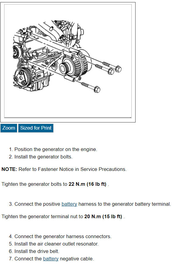

I need to know how to change the Alternator on my own. Wondering if you have a diagram showing the placement of the alternator??

You should start by disconnecting the battery. Here is a guide to give you an idea of what you are in for when doing the job.
https://www.2carpros.com/articles/how-to-replace-an-alternator
Here is what it will be like on your car (below)
