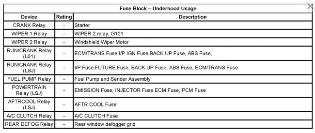

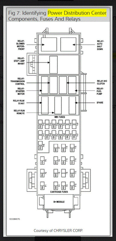

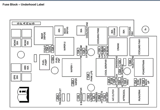

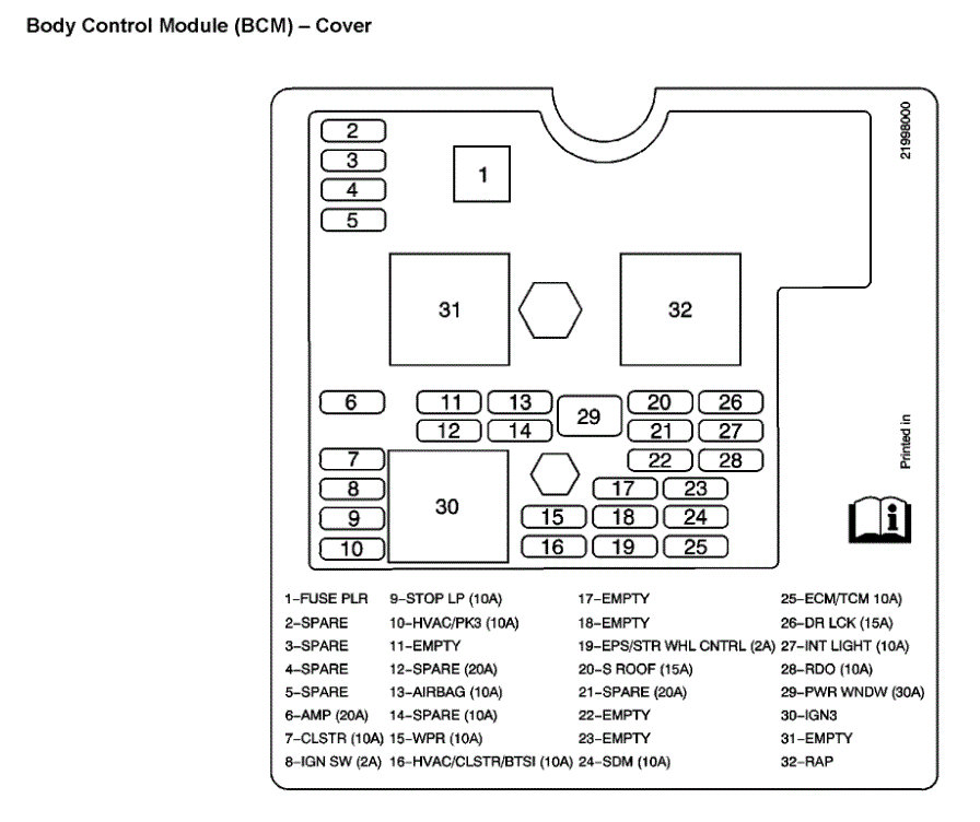

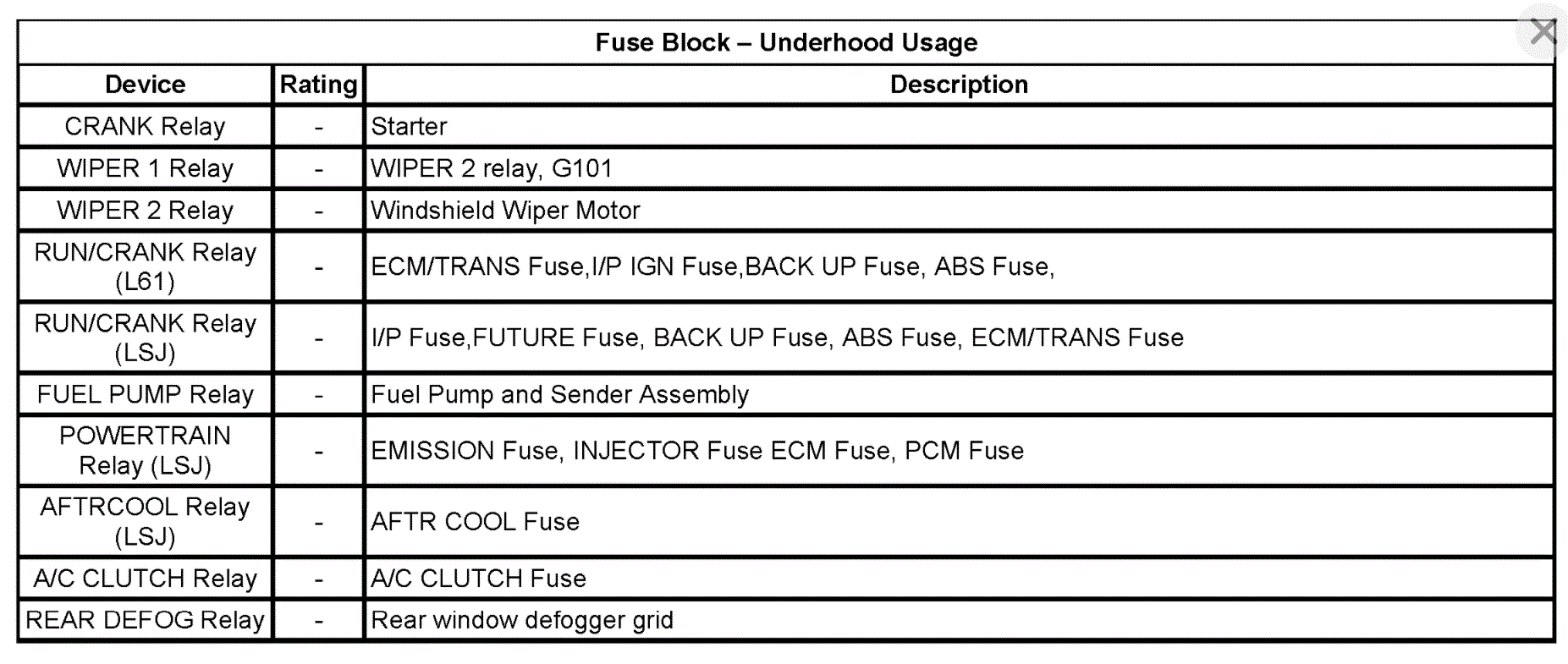

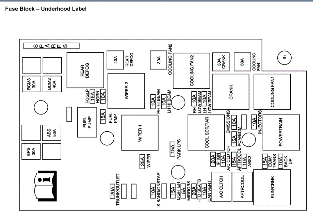

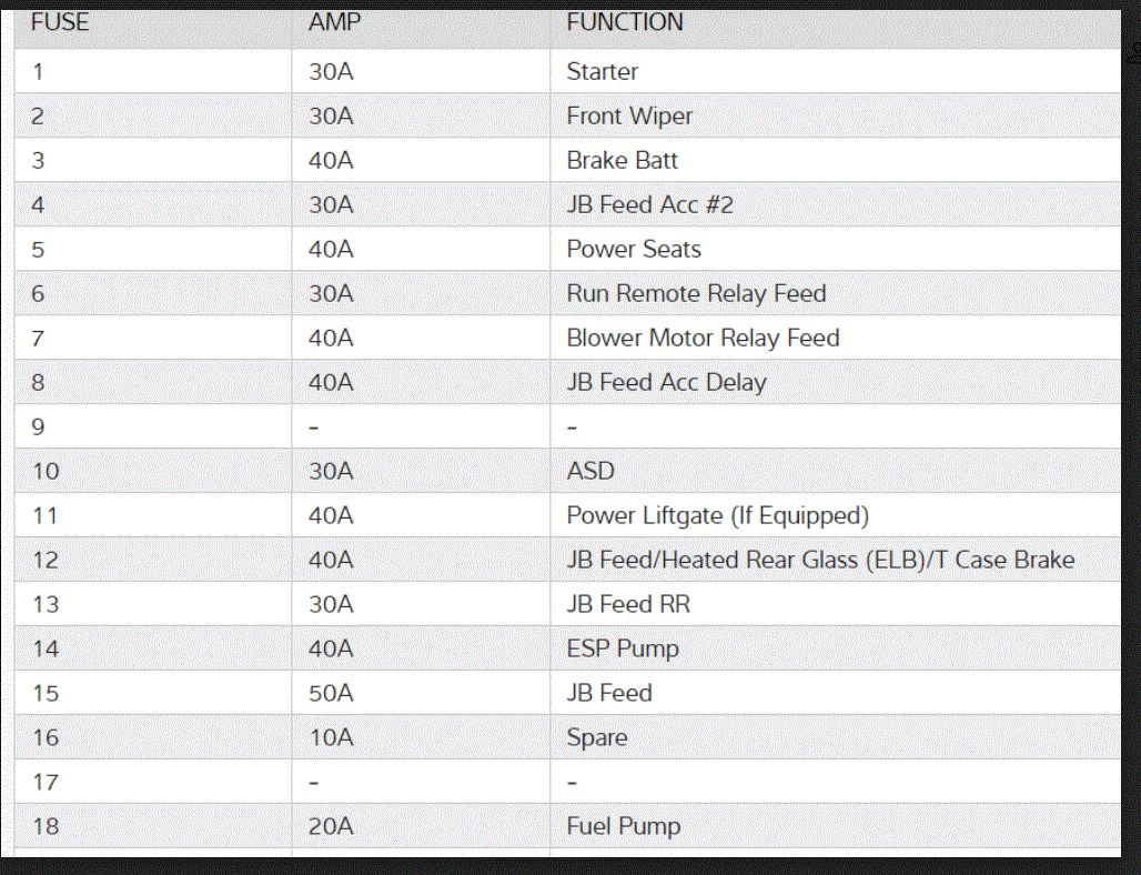

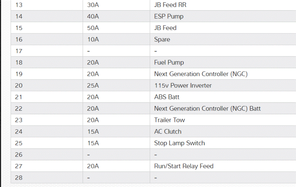

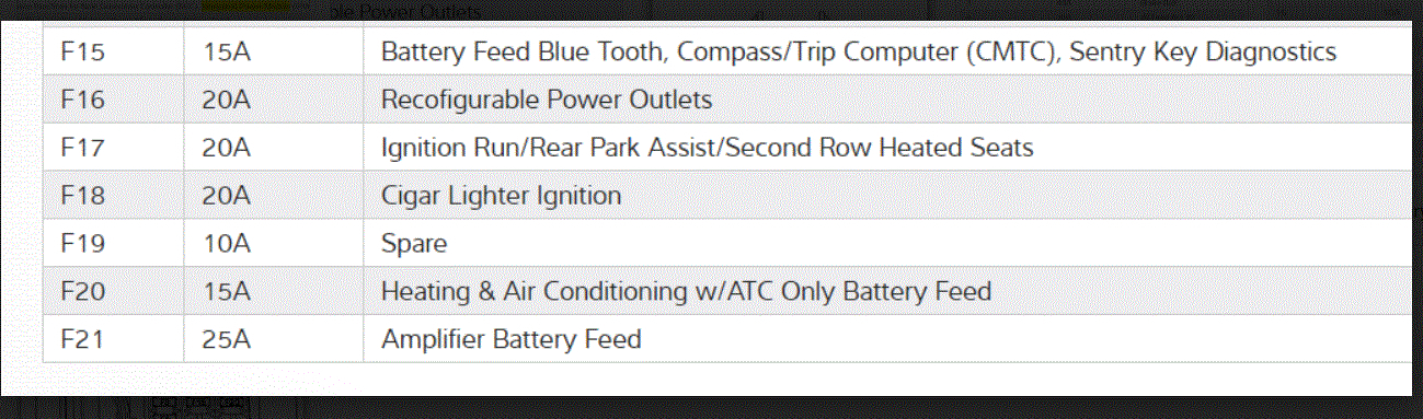

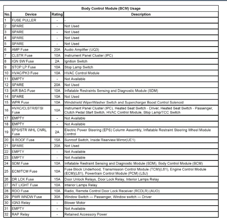

If you look at the attachments below, they provide the fuse box orientations and what each fuse is for.

See pics below.
