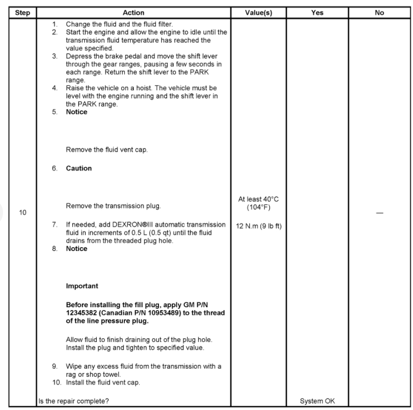

How do you fill the automatic transaxle with the correct amount of fluid? I lost an unknown amount of fluid when working on the radiator. There's no dipstick or method to fill from the top of the engine compartment that I can see.
Feb 20, 2010 at 6:03 PM
In most cases the fluid can be checked using a dipstick and this guide shows how to do this.
https://www.2carpros.com/articles/how-to-check-and-add-transmission-fluid

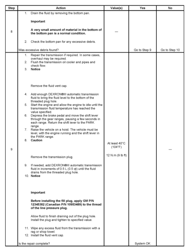

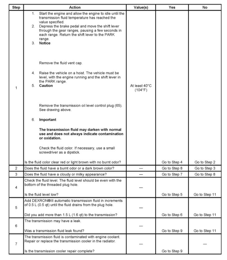

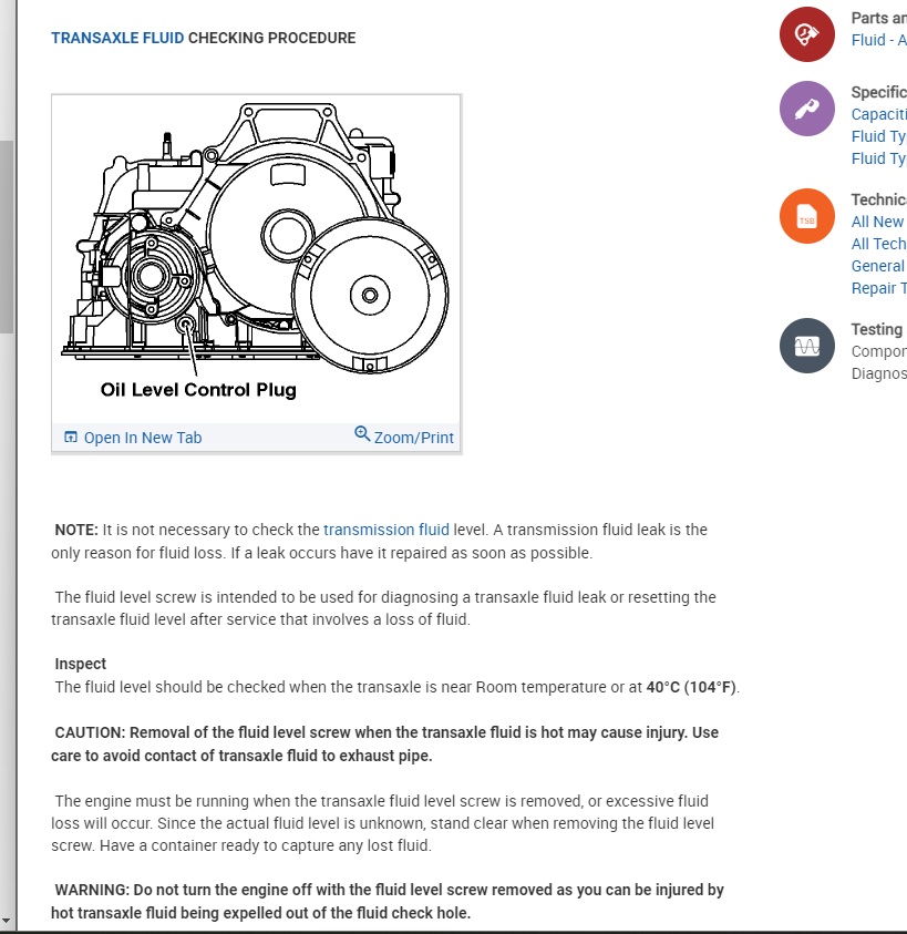

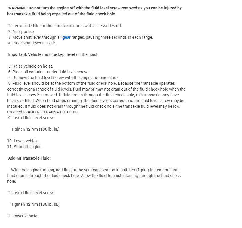

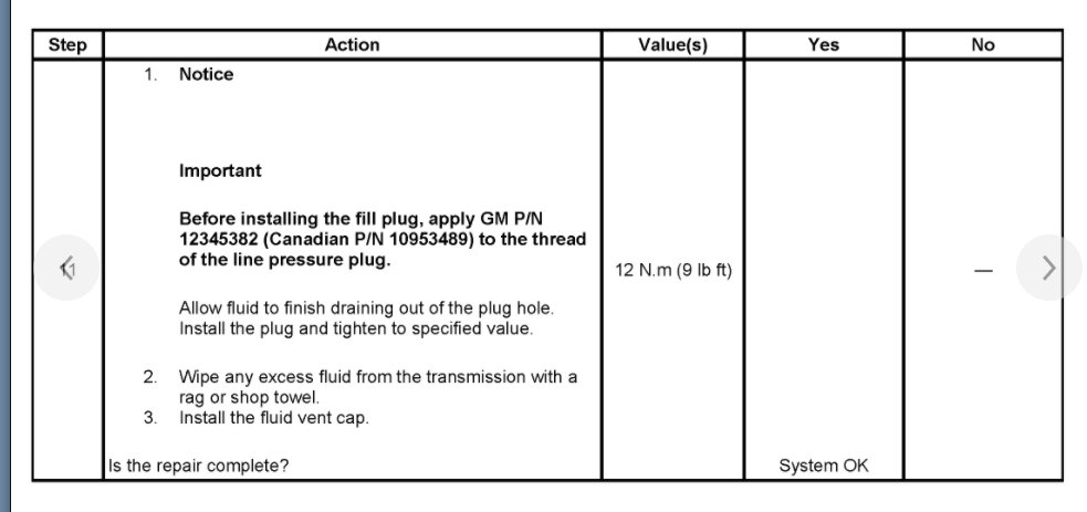

However, on your vehicle the transmission does not have a dipstick, instead there is a plug in the side of the unit that you remove and basically fill the unit until the fluid runs out.
This is a bit confusing, so we need run through the complete process that I attached below.
Please let me know if you have questions on this and we can go from there. Thanks
