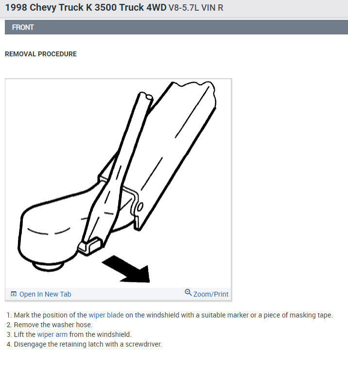

Trying to remove and install new wiper motor on my 1998 chevy 1 ton crew cab. I believe it is built on a suburban classy. I can't get the cowling off! I have removed the screws on both ends but there seems to be two tabs of some sort still holding it down and I can't figure out how to make them release. I know it can't be that difficult because windshield installers do it several times a day. Thanks for any suggestions or instructions, Nick

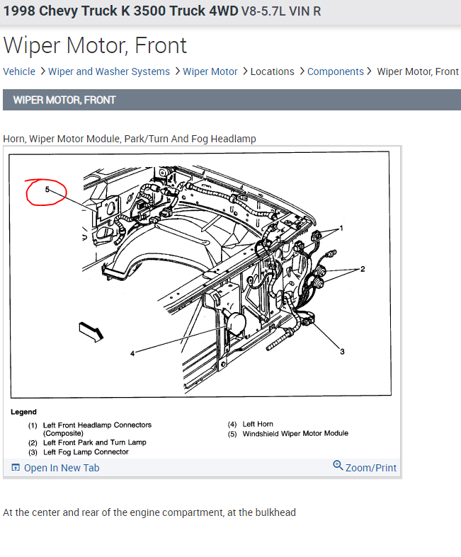

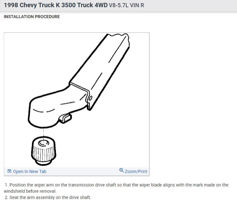

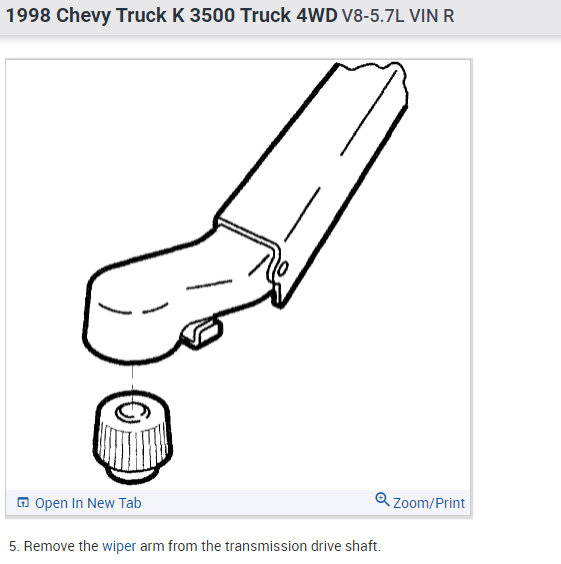

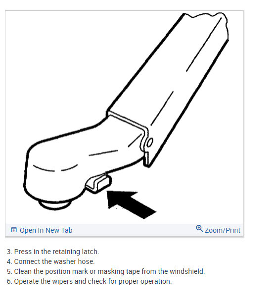

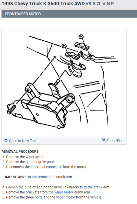

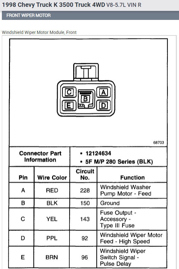

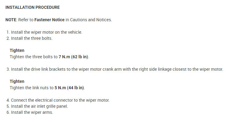

In order to remove the cowl you will have to remove the wiper arms.
And sometimes you will just have to give it a good pull as sometimes the clips can be stubborn.
Replacing the wiper motor can be done using simple hand tools. Should take about an hour, depending on your comfort level.
