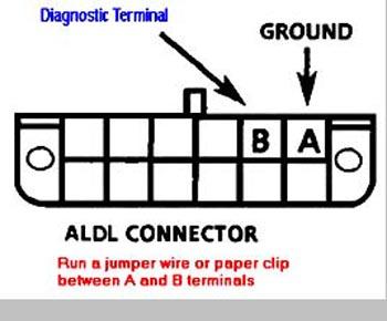

What should I do next? Is there a way to check the codes, ( this is a 1986 model ) like you can on the newer cars. IF so, where is the connector located, and, what is it called ( newer ones called OSBD2, i think)

You have the OBD 1 set up. With a jumper wire, jump A and B. Turn key on (don't start engine) and count the flashes from the check engine light. Each code is a 2 digit number. Let me know what you find.
