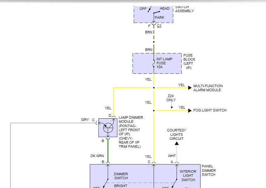

Check the interior lamp fuse, note the diagram. Not only check the fuse, check for voltage on the fuse circuit. That circuit goes hot when you turn on the headlamp switch. From there the voltage goes to interior dimmer. Sometimes the interior dimmer is turned low to the point, no interior or instrument lamps. So rotate that dimmer, see if it makes any difference. Go from there.
