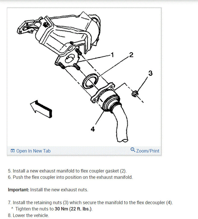

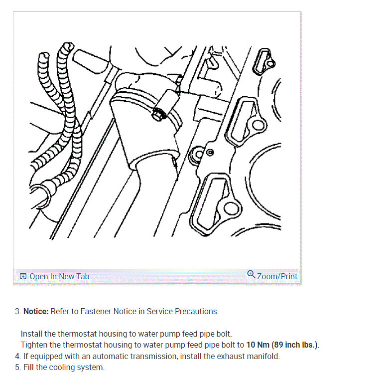

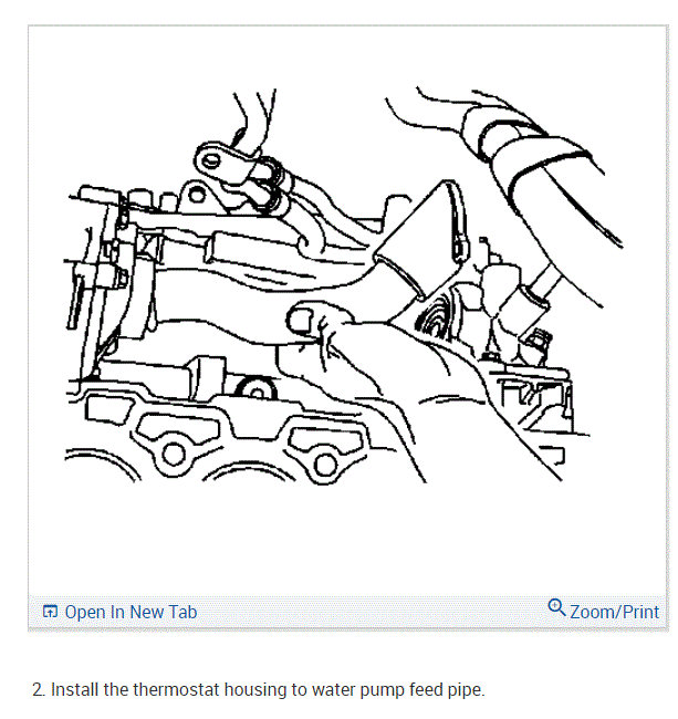

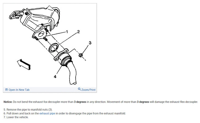

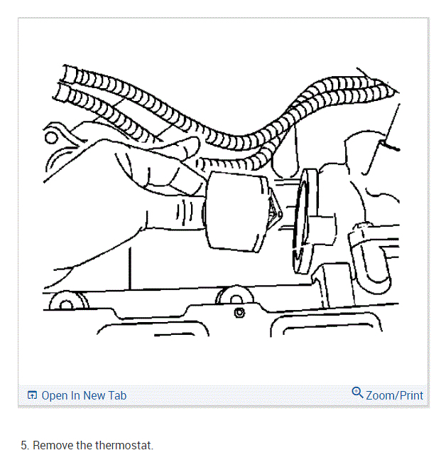

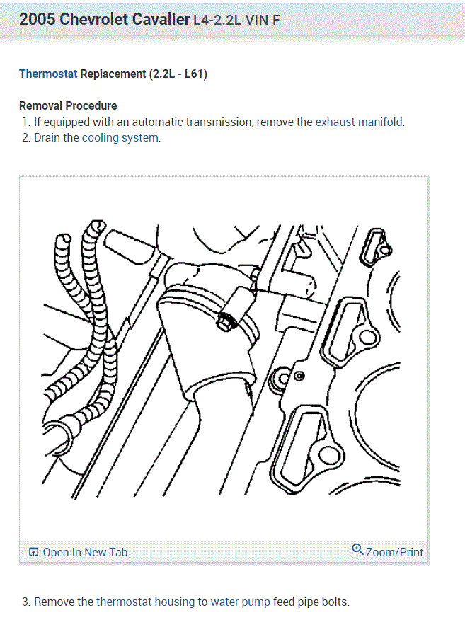

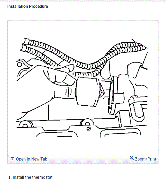

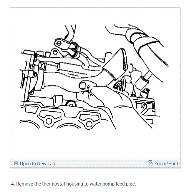

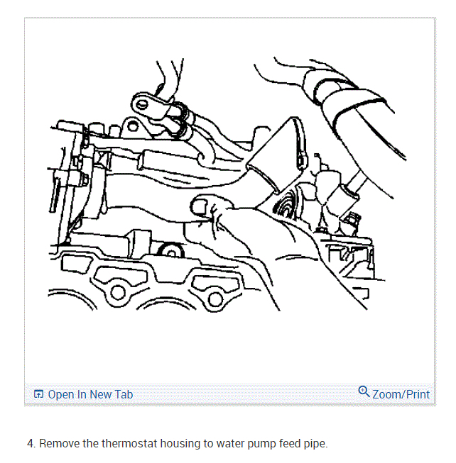

How do you change a thermostat on a 2005 Cavalier with an automatic transmission? I understand the exhaust needs to be removed but HOW is that done? Do I need special tools? jacks? other special equipment? Why is this such a difficult job? Can this job be done in my driveway with everyday tools? I have no garage to work in.
