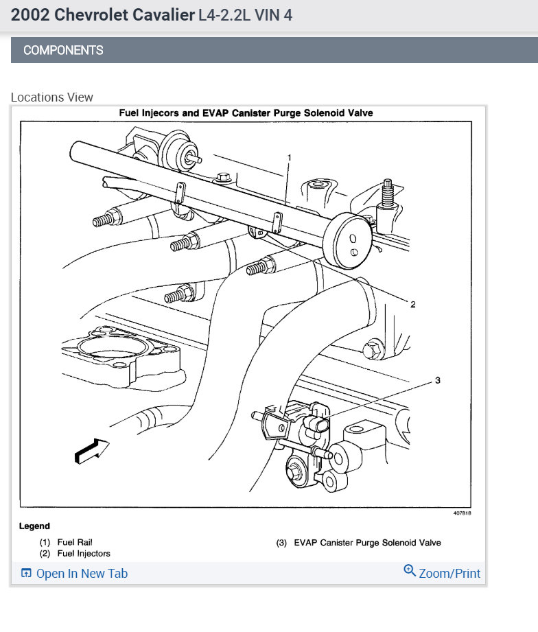

where is the purge/vent solenoid on and what is the easiest way to change it?
Jun 19, 2020 at 12:21 PM (Merged)
According to the manual it is on the side of the engine, above the oil filter under the exhaust manifold, , be sure to check the hose going to it for damage as well. Check out the diagrams (Below). Please let us know if you need anything else to get the problem fixed.
